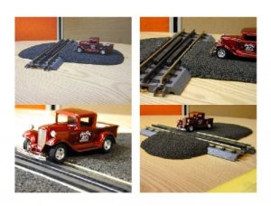

Good Idea Matt ;) I was looking back in december for the same thing and had a hard time. I was researching for an O gauge road we built for a coworker. The truck was kitbuilt by my cubemate.
Here's what I came up with..the roadway is made form different sized ballast mixed with white glue, I used walnut mini lumber stained with black watercolor for between the tracks. This sits on an xmas layout. I may have other stuff I saved from my research, I will look for it and post it here.

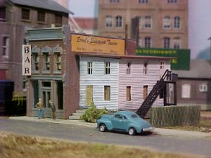

I've been modeling in N scale, so foam core, & some other types of cardboard that work well in HO, are a little too thick looking in the smaller scale.
In this little scene, I made the street from a piece of thin cardboard that I cut out from an empty structure kit box. I painted it with some dark gray craft paint, & then weathered it with various brown & white washes of thinned Polly Scale paints.
The sidewalk/curb is a single piece of matting board (available at craft stores, & anyplace that does picture framing) that also serves as the base for the structure...I used the structure itself as a template. Remember that your sidewalks need to be on top of the street, & the structures need to be based, or shimmed in such a way, that they are on top of the sidewalks.
The sidewalk here is painted Polly Scale Concrete
