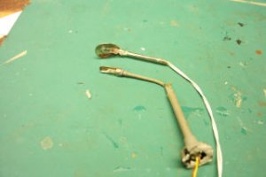

Remembering someone mentioned North American telephone poles with streetlights in the "What Detail Parts Would You Like To See" thread, I thought I would try to scratchbuild one. Here's my first attempt.

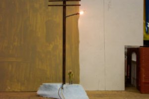

Here's another one, on my test transformer, all lit up.
I started with an HO scale lamp from Life Like, but it was big and looked out of scale, so I opted for the N scale one instead.
eightyeightfan1
Now I'm AMP'd
2,772
61
Torrington, Ct.
Its an Evergreen Plastics tube, capped at one end, and a hole drilled in one side for the light. The wires run down the inside of the tube. I will drill a hole in the layout to "plant" the pole and pass the wires down through.
Won't even see them.

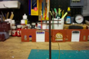

Originally posted by eightyeightfan1
someone mentioned North American telephone poles with streetlights in the "What Detail Parts Would You Like To See" thread...
That was me! Those are looking good Ed. Do you perhaps have a photo where there's not so much in the background? I'm finding it a little hard to see the lamp.....

Thanks Guys and Val,
They are actually the arms that I cut off of N scale street lamps.
I was gonna post a step by step, I have taken pics of each step...But I changed my mind...because I used the HO lamp and it looked funny.
