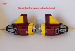

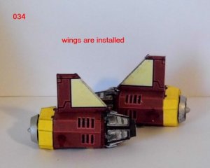

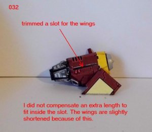

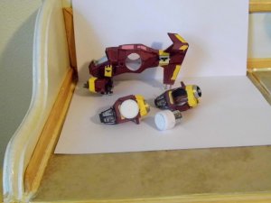

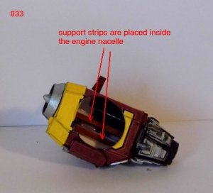

So on with the next batch of photos. The wings are a little too flimsy so I do what I do best, LAMINATE, LAMINATE. Because I changed the property of the original design, I have to insert it into the engine pods to maintain integrity. I forgot to compensate for this and the wings are slightly shorter than called for. If you laminate them, add an extension to go into the slot. Talking about the slot, Make that cut when it is flat. Once the model is three dimensional, you have to be extra careful in cutting the slot out. I also had to make some internal support for the wing slots. Enjoy and see you all next posting. I have a bunch of photos to edit for your enjoyment.:wave::wave::wave:

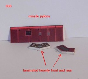

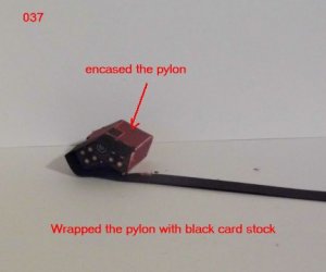

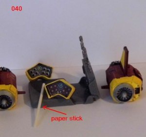

In continuation with the build, Here is another technique for the missile pylons. The front and back were laminated heavily, especially the front. The reason for the heavy lamination, is so the it can be drilled and the front will not collapse or get destroyed by the drill bit. I started the drill with the smallest drill and drilled again two more times with increased size of the drill bit. If you start with the larger drill bit, it will tend to move and destroy the part. With the smaller hole, the larger bits will have a guide to drill on. For the front edge of the pylons, I wrapped a black card strip and then I rolled a white strip around it. This will give it a deeper depth like on the GW version. Enjoy and I will see you soon with more stuff and techniques.:wave:

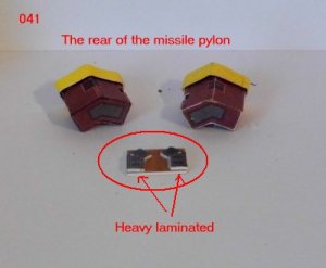

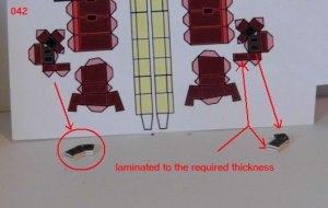

Now to continue with the build. At the present I have started with the fuselage from the back to the front. There is some minor fit issues but I will see how to overcome them. Here I started with the rear of the missile pylon. Too many pesky tabs so I just laminated to the thickness. Instead of hand painting the part, I wrapped a thin strip of black card stock and I am going to leave it black. The vents are too close in this part to be able to properly cut them out so I just raised the surface with thin panels.

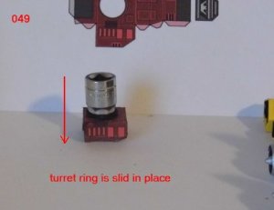

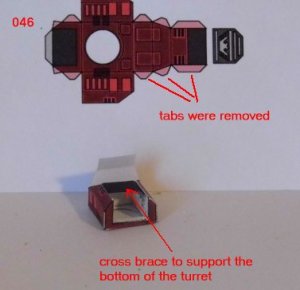

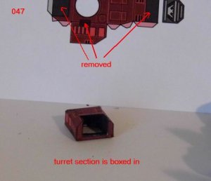

So here I am starting on the nose gun tub. Took the tabs off and recessed the gun mount. With a strip of card stock, I made the tub ring for the traverse. This section of the thread took a while because of the details that will follow soon. Enjoy and see you all next post.

Why do you prefer to take off the tabs? How do you support the pieces to be glued without them?
One of the problems I have with my models is keeping the parts "square". Does removing the tabs and placing your own supports help that?

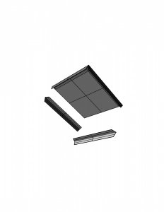

I make L shaped pieces to the appropriate length. The reason i write "L" shaped, is because I only bend enough to get a 90 degree bend or whatever degree bend is needed. A simplified small picture is attached. I trim the tabs so they don't overlap. This also serves to form an inner frame or skeleton that adds significant strength to the assembly, and can even serve to help anchor an inner box for strength if needed. :)

I usually take off tabs but I do use them as well, it depends on the model. For airplanes, I definitely take them off and make tabs that I glue from the inside. This method allows for the parts to one built flush and not have a part overlap and have a raised surface where one should not be.

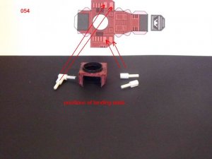

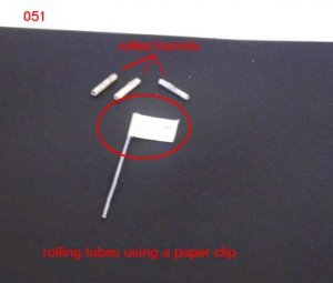

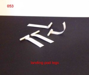

Here is the next batch of photos which is mixed gun barrels and landing gear. The reason for the mix match is that I have to wait for the parts to set before I can handle them. especially the barrels.

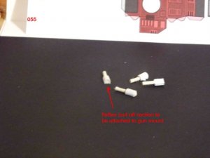

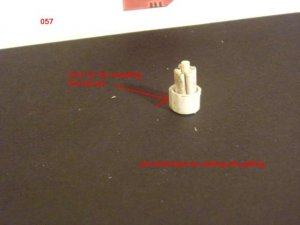

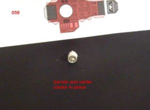

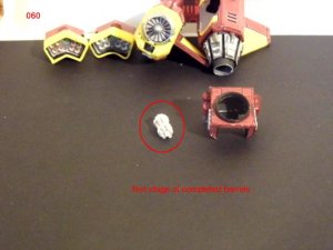

The talon is coming out pretty good. I am now looking at the making of the cockpit. In the mean time, here is the next batch of photos. Continuation of the Gattling and the landing gears. This is one version of making the gattling.

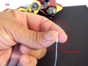

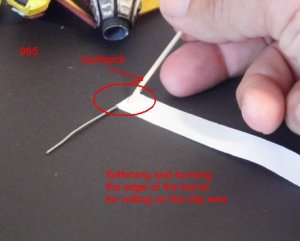

More photos. I have about 150 in the photo series and they need to be edited and captioned first. Here are some mix match photos of the gun tub, landing gear and the gattling gun.
