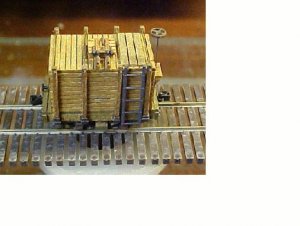

I think it was Casey that posted a really neat picture of a little sand car that had gotten left on a side track.
When Ezra P. Terrible, owner of the East Terrible Mining Co. saw it he turned to The Robber Barron and said..."I need something like that to haul 'Shine in....now get your butt busy!!!":eek:
Here's the result...still in the shop awaiting its lettering but its fit to be seen:D In true Robber Barron fashion its scratched from a set of kit plans borrowed from a friend:eek: :D :D :D

Very nice! Put that car in the middle of the train and all the brakemen should stop complaining about having to walk to the back of the train to uncouple cars! Of course, the conductors will start complaining how the brakemen take longer and longer to get the job done with every stop!;)

What scale/gage is that little puppy?
That is one sweet pea :p I guess HOn3 since his profile indicates it's an interest. Now if only we had a multi-scale/gauge narrow gauge forum to talk about it :D :D :D hint-hint-hint :D :D :D jon

Thanks for the compliments gentlemen.:)
Ron & Jon....Its HOn3
Pete....Now that you mention it I left off the hose for the spigot!!:eek: Would be kinda hard to guzzle without it!!:D :D :D
Please don't tell Ezra....He'd have my butt for that!!!:D :D :D

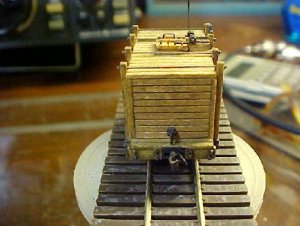

A BIG Thumbs Up!
A moonshine car! Absolutely HILARIOUS!!
Can you PLEASEPLEASEPLEASEPLEASE post the plans, or email them to me? I simply MUST make one for my On30 logging line!:D

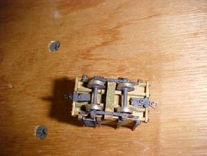

Hi Steve and John, I don't have a scanner to scan the plans but they are about worthless anyway....The orginal kit was pre-cut and the instructions contained no dimensions. The one "cruddy" drawing was not to any scale so I just guessed at what size it ought to be. Everything for the most part is built out of N scale scribed siding and strip wood. Its just a box that sits on a frame with an HOn3 truck glued underneath that. The stake pockets are some that I had in my scrap box. Grandt Line's should work OK. The ladder is again out of the junk box as well as the brake wheel. The NBW casting are Grandt Line. Couplers are Kadee N scale with the trip pins cut off. The hatch hinge is Grandt Line. The spigot is a piece of wire squeezed in a pair of pliers and filed until it looked right. The truck is a Grandt Line D&RGW freight truck. I cut away the plastic bolster and added a piece of scrapwood in its place. The original one won't work because its tapered. The orginal kit had some kind of special truck casting. Here's the dimensions that I used and a photo of the underside/frame. All are HO. Good luck with yours and post a pic! This is one of those things that you can "go wild" on if you want to!!!!
Length over endbeams... 11 ft.
Width..... 6.5 ft.
Tank.... 6.5 wide x 9.5 length x 5.5 high
Uprights... 7 ft.
Frame.... Made from 4x6 HO strip
Note....To get the coupler height correct you may have to shim the truck to raise the carbody before gluing the truck in place. The truck does not swivel.
Great! thanks for sharing. Hafta see if I can put a littel spin on your idea :)
Is any N gauge knuckle coupler the standard for HOn3? Do you set the height to N gauge standards?

Hi Jon, The Kadee N Gauge coupler is often used in HOn3 when you have restricted coupler box clearences. Its not really the standard but the N Gauge coupler and the Kadee HOn3 coupler are identical in construction only the N Gauge coupler is about 25% smaller. They mate up and operate just fine with the regular HOn3 coupler. I use the height standard as indicated on the NMRA HOn3 Standards Gauge.
