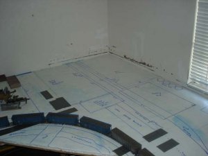

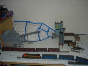

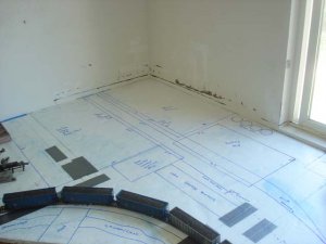

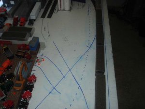

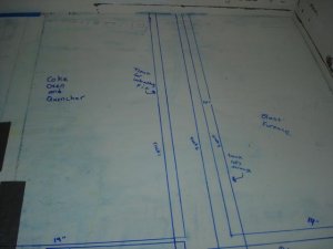

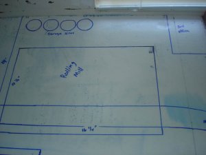

Well you were right, all 4 did not fit and I barly was able to get 3 of them (Blast Furnace, Coke Oven & Quencher, and Rolling Mill). I had to move the Blue star and the Asphalt plant down and take the Bulk Transfer conveyor/Pit away from the concrete/asphalt complex but I am happy with it. There is still 1 crossing in the spot were th 90 degree was only it's not a 90 now, I have to figure out what it is. I ran out of room for one of the tracks so I plan to put a tunnel or bridge that goes almost the whole lenght of the layout (dotted line)
Heres some pictures:

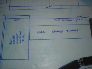

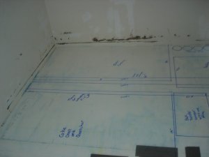

The buildings are drawn to scale according to the Walthers Dimentions and the code 83 track was used in drawling out the track plan.

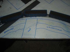

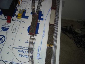

Here's the tunnel or bridge I was talking about. It starts over by the New River Mining Company and ends at the coke oven.

If I do the tunnel, I will just make it go under ground at the enterance and exit and not go all the way. Because of the benchwork, I would have to do a lot to make a complete track run under it. If I do a bridge, it might look a little dumb since it would go the almost the entier length of the layout.
I think Im going with the tunnel idea. This track is for the coke oven and quencher and I could not fit another switch in on the mainline exept for other end of the layout.

I added 2 more tracks to the above pictures. 1 goes behind the rolling mill and to the storage silos. This track comes out of a tunnel that meets up with the other in the tunnel.
The other track also comes from the tunnel and goes in between the blast furnace and coke oven. There is a slip switch that I put in on this track also that connects to the track running next to the blast furnace.

wait, why are you building the this tunnel again?
EDIT**** sorry, i mixed the quencher and retort in my head.....
The Coke oven doesn't have to be on site either. Often times these businesses situate themselves near where there are many steel mills (often times they don't even belong to a steel mill). they aren't a part of the Blast furnace/rolling mill area. I think you should just either make more space for the coke oven, or remove something you don't want.
or just leave the coke oven out. it doesn't neceisarrily need to be on the layout. The only buildings you need is the Blast Furnace, because thats the one everyone identifies with a steel mill. You should add the rolling mill because its an intersting part of the complex that would be there.
The only other thing you need, is a track with a pit for coke hopper, and a track for the rolling mill. Thats all you need for that corner of the layout. The other steel mill buildings wouldn't be there, they are just part of the process. It would be unreslitic in real life to have a coke oven right there on site ( although the coke ovens try to stay close)
Also, Usually a steel mill has its own little industrial railroad. The main railroad ( in you case BNSF) would only ship cars in bound to the steel mill, and cars leaving the steel mill.
You'd only need a track that goes off behind a building and call it an interchange track.
If you do ever get the space though, i reccomend buying a small swithcer (like Bachmann's GE 70 ton switcher, or an early EMD switcher with a low cab) as these are the locomotives that would have worked on a the insides of a steel mill, not your big B40-8.
so there you have it, 3-5 tracks. 1 or 2 that go over the coke pit, 1 or 2 for the rolling mill, and another track for other inbound cars. thats all you need to put in that corner, and it will probably fit better. save the coke oven for another day.

The tunnel is there because i could not fit another switch in on the mainline close to the complex. I think that it is ok though. I have desided that im not going to make the tunnel complete under the table. The tunnels will simply start at the tunnel portals, go maybe 6" and then stop. I will put track bumpers down in the tunnels where they stop just so I don't loose any cars. sign1 sign1
Well the only promblem is that I asked my parents and grandparents to get me this complex for christmas and I already started getting the buildings. I already bought the Rolling Mill and Coke Oven & Quencher. I no that the coke oven is not supposed to be on site and it is not prototypical, but I will deal with it and I think it will look great. :D :D
For the pit for the coke cars, the coke oven and quencher comes with a pit for coke cars and I also added a Bulk Transfer Conveyor w/Pit (Walthers). So I don't have a problem there becasue there will be 2 pits. I also have 2 storage bunkers drawn out next to the bulk transfer conveyor + the coke oven comes with a big storage container.
I will try to fit anothertrack behind the rolling mill and blast furnace for the inbound cars.
Thanks so much for your help!!!:) :)
yeah, thats a good idea, as long as it appears like the tracks are going elsewhere!
You can't fight for a little extra space on one end, lol? How much space could the coke oven/quencher need? is there any room past that rock crusher?
Thats actually a coal pit! the coal goes to the pit, then its transferred from there into the ovens. The big stoprage container is where the finished product goes. There should be some sort of arrangement for the finished coke to dump into high capacity hoppers desinged to carry coke.
You can leave the coke cars out of the whole layout now, and just build a conveyor or something from the coke oven to the blast furnace. Because coke is EXTREMELY brittle, Coke ovens and steel mills attempt to handle it as little as possible, because everytime the pieces clunk together it creates more coke dust, which is very bad for steel making.

green_elite_cab said:
"yeah, thats a good idea, as long as it appears like the tracks are going elsewhere!"
Yeah I will make sure it goes far enough down so it is not noticable.
"You can't fight for a little extra space on one end, lol? How much space could the coke oven/quencher need? is there any room past that rock crusher?"
I already have enough room. I measured out the dimentions of the coke oven on the table and drew them out. The concrete plant, asphalt plant and Glacier Gravel complany are all there and fit tight but good.
"Thats actually a coal pit! the coal goes to the pit, then its transferred from there into the ovens. The big stoprage container is where the finished product goes. There should be some sort of arrangement for the finished coke to dump into high capacity hoppers desinged to carry coke.
You can leave the coke cars out of the whole layout now, and just build a conveyor or something from the coke oven to the blast furnace. Because coke is EXTREMELY brittle, Coke ovens and steel mills attempt to handle it as little as possible, because everytime the pieces clunk together it creates more coke dust, which is very bad for steel making."
O that's a good idea, a conveyor from the coke oven to the blast furnace:thumb: :thumb: I will do that.
