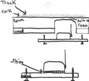

prodigy2k7,,, this is kinda out of my ballpark if you know what I mean ,, but if I was you I would go ahead and buy one switch machine and see what you can come up with,,,,,, and if it doesnt work you can throw it at the puter for me giveing you bad advise,,,, but I bet you can come up with a way to make it work,,,,,, might be able to cut a hole in the foam and in the wood,,,, then mount it to a seperate piece of wood and screw the wood on under the table,,,, that way you could shim it up the height you needed,,,, ,,, hope that helps,,,, ,,,,, ,,,,, st

prod,,, I figure its a saturday morning and everyone could use a good laugh so i tried to draw a pic of what I was talking about,, kinda figure you already made it to the LHS but if you got a switch this might still help explane what I was talking about,,,,, good luck,,,,,by the way, I'm not a artist by trade,,,,, (edit-Im not sure what your switch machines look like but I figure something along the same principal might work,,, again, good luck,,,,,, ,,,,,,,, ,,,,,,,,,,,,, st

not a bad idea but i dont have much to cut a hole in the wood with lol... and the foam, i got the bead foam, isnt that harder to cut? lol
I might just buy one and see what happens

Okay, I finally went to my LHS, The problem I have is YES its too thick. On the paper it says it should be max 1 inch, I am thinking of not using foam at all... Do i need foam for smoothness if im using roadbed? hmmz... I guess for the inside though... Or maybe get a thinner piece of foam.. TO me it would be easier to glue down and mark where my roadbed should go.
