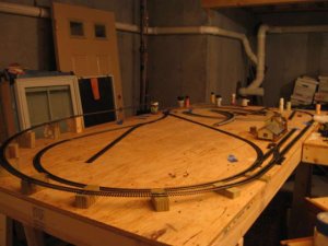

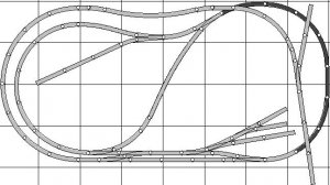

Hey guys, I thought I would post a layout thread where I can put down all my layout stuff and help motivate me to complete this layout :thumb:.
Well, to start off, I am working on a simple 4x8 table now, but this will hopefully serve as the learning grounds for my future expansions and so forth. I believe I had posted this once upon a time, but the username and password are long lost to me. SO.. I decided to just get a new one and start all over.
My track plan is below, and I currently have all the wiring and everything else done for the lower portion:mrgreen:, except for the upper portion, which will include an incline and trestle leading to a coal mine or other industry and then off the layout. Once all the track work is near flawless and running smoothly I can start the scenery and paint the track. Also managed to install some decent lights above the table to help see during the long winter nights.:cool:
I havn't fully decided the era or location, but it most likely will be a fictional railroad somewhere along the Appalachian mountains. I have a Western Maryland locomotive now, but hopefully some Boston and Maine and others can look somewhat at place on it in the future.

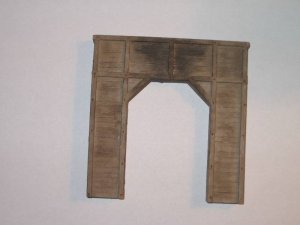

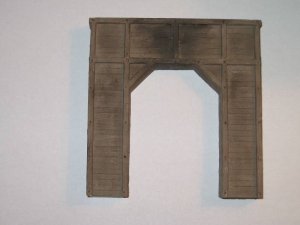

Here are some tunnel portals I did. I still have one more stone portal to do, but i am having trouble darkening the stone. I have been trying a black wash, but it only seems to make the portal fade. They are plaster woodland scenics ones, so I am not to confident with the permanent coloring yet, but I guess ill have to get over that :rolleyes:

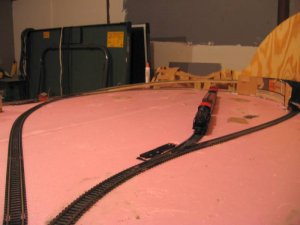

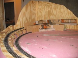

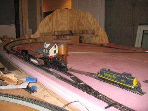

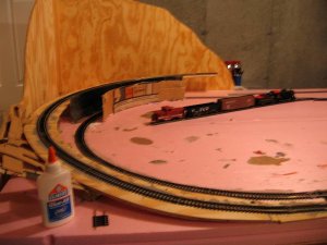

And here are the current, up to date shots of the layout. Sorry, it isnt pretty yet but I'm working on it :p The only real improvements are the completed reversing loop and right fascia. No need to worry though, I'm workin on it :thumb:
Also, does anybody got any good suggestions for visual aid on the reversing loop?. I was thinking of installing a LED in the switchmans house close to the operators controls to see if the train could go through. i.e. Red for opposite polarities, green for go. Could I use a signal or something as well? It seems I fried the other LED when testing it out. Would a switch fry as well? or does it have built in resistors and such to save it? Either way, I would really like something there and any recomendations of an early prototype signal would be helpful. :cool:

That's a nice layout. Those portals are nice, did you make the wood ones yourself?
What are you using for a black wash? In my experience it's better to paint the entire plasterwork in an acrylic color and then go for the wash. The acylic paint gives the wash a little 'tooth' to grab onto.

Glen Haasdyk, the wood ones are from woodland scenics as well. They really make some fine stuff over there and the detail is great. Acrylic paints are my preferred medium, and all three of these tunnel portals are entirely acryllics. I have been trying to use a diluted black acrylic paint for a wash, and that seems to be the problem as to why it washes off the color underneath. It appears that once you go past 50/50 with the water it doesnt make it darker any more.

Do you have an air brush? If you do, paint your tunnel portals your rock color, and then highlight it with light passes with your air brush.

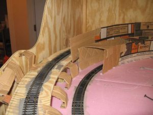

I figured i should probably update what I've been up to in the last month. I can never remember to take pictures or log my work but I'll try and be more consistent :rolleyes:. I've been working on my layout 3-4 hours on the weekend, and have managed to get all the track done and begun to start some scenery. :cool:
I built up my cardboard mountain and then proceeded to cover it in some paper towels dipped in a fairly thick soup of plaster. I didn't use the cheap, heavy duty brown kind that most people recommend, but I had acquired a large amount of the other kind and decided to use them. They seem to work well and are very strong after only one layer of plaster, and I put on two for good measure. After the primary layer of plaster, I used the second layer to really sculpt and define the scenery to try and get it to the final stage.
I painted on a base layer of paint as well, but I think it is a little too dark. I plan on covering the entire surface with dirt and hopefully this will make it lighter. At the very least i could just paint on a lighter coat.
