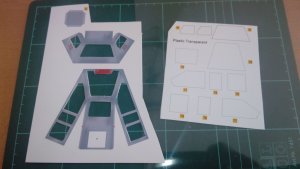

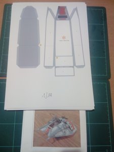

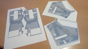

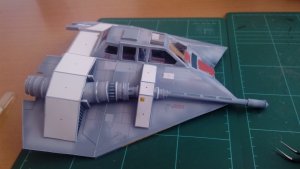

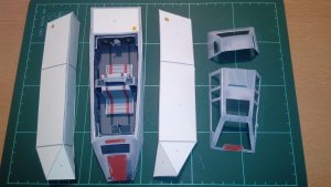

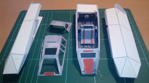

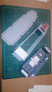

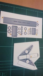

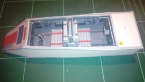

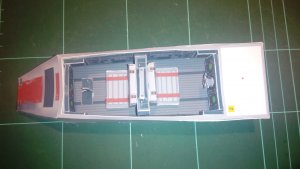

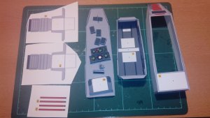

Hi again,
another beautiful model found on "paper-replika.com" - the T-47 Snowspeeder. Only short appearance in SW - EP V - but a cool mashine.
The model consists of 14 sheets and over 100 parts. Puuuh - how long will it take and how difficult will it be?
But there is also a description which will guide me through the building process.
May the force be with us.
Now the pictures for the start - did not get any troubles so far.
Maybe the front-panel has to be corrected - I think it should not be round. I will decide when the next parts are coming.

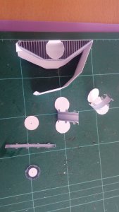

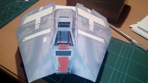

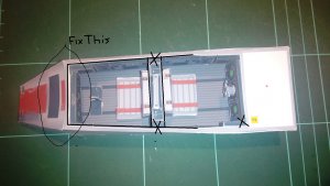

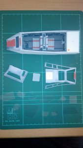

Off to a start, but before this comes back to bite you in the "end", fix the part I have circled, in the very least. Cut off the tabs. Make your own with scrap pieces of paper, that way you can line up the endges perfectly.This is is one of those models where everything has to be squared and the angles have to be right on the money. It may be better to cut parts than fold them. You will get an accrued intolerance which will make your model very unsatisfactory to yourself, based on the standard you have shown to us, and that you build at. Even if it means cutting it out and doing it again, it is too primary a feature to leave curved like that. Straight lines, and sharp crisp angles are the hallmark of this particular subject. Some of these spots should be reinforced with balsa wood strips if possible, anything to beep them straight. Color the edges of the parts too. This is where you might think of end result first. If you make a box, which will you see. Should the top of the front panel be visible from the top? Obviously not. Make the top the top, then you only have one edge you have to color in to match up. Any color works, it does not have to be a perfect color, but any color other than white, unless the parts is white, is better. You will have to build the outer box again, or disassemble this one, and remake it absolutely squared up. It will save you much trouble in the end. I follow what you do, I like your builds. I don't offer up critiques unless the modelers is worthy and has shown themselves to be a solid person. The picture I inserted shows how squared, and on the money the lines and angles must be. Each assembly builds on the priors connectedness. In reality, these models are harder than models with many curves, where much can be hid, it is not a simple model to build, and have it look good, that is. The space between the back and front seat (marked with "X") is a bulkhead. That part should be perfectly squared, and go all the way across. It is structural and will make the tube square up, and give it strength. That is why the white space on the floor goes all the way across. That is a part that if you use that tabs, will be almost impossible to make straight. It would be a great spot to stick a wing spar through to help when mounting the wings. You don't have to make these things exactly as they are shown. Plan ahead, Dnalor's thread is a great reference, those his is so big, you can get in it!
Get a good metal straight edge to fold with, and only fold as far as you need go. Symmetry is paramount. The wings will maintain symmetry. mounted to the fuselage, or "body tub" as it stands now. Good time to greeble too!
You cut those parts out perfectly, then somewhere, probably with the tabs, it started going off. Tabs are the bane of modeling. I always cut them off. Take this all with a grain of salt, or start over again, and make each part perfect. you will then want to put the model in a glass case and years from now, you will wonder how you had the patience to make it!

@ Zathros and dnalor - many thanks for the given hints. Be sure that I will never understand as criticism but as friendly tip to help.
I use inkjet carton (not normal paper) for all my models. And so far I did not have too many problems with it.
As I am still a "young padawan" in modelling I still have much to learn. Also I am not (until now) experienced enought to make amendments for given models.
So I am listening to every tip and hope to get able to see problems myself (mostly I do) and to solve them (this is what I have to learn - help appreciated).

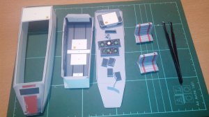

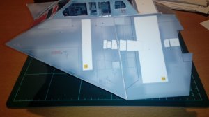

Before reading the posts I already made the next parts including the assembling. (Cockpit and side parts)
As mentioned by Zathros and danlor - the not 100% exact cut or fold parts, caused problems by the assembling. I tried my best to "repair", but as I am not that experienced I have to live with my unprofessional solution.
But....this is a model I find worth making a second time when I am more experienced with paper modelling. And with the next version I will sure use the given hints. I alredy got several tips within this forum which helped very often - thanks again to all who ever gave hints.

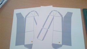

@ I did build the wing carrier boxes on the side wrong....and i had to be very creative to fix it with a lot of gap-filling glue :)
Here I was lucky - I think I made them correctly - I think.

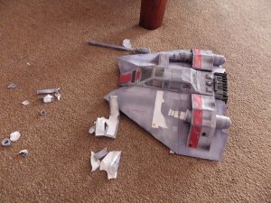

Nice job! Another one I've built as well :) I actually got frustrated with it, (also made some rather obvious mistakes as well) all the structal faults that Zathros mentioned reared their ugly heads. :( I did finish it but didn't cry too much when the toddler got hold of it.... (and we know what happened next)
I have the old micro machines model of the snow speeder and when comparing them....(spoiler alert :)) there is absolutely no detail on the underside of the paper-replika model!
Oh sorry to see the disaster with your snow speeder.

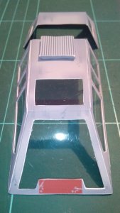

The cockpit Canopy and glass is right on the money!! You actually did a really good save. Want to cheat a little? Print out the center section page, cut it out, back it with firm cardboard, or even cut up Popsicle sticks.
Cut out the center front piece. Don't leave any of the front center on presently there. Cut it out completely. Make two long 1/4" wide "L" shaped pieces and mount them such that when you mount the new center front piece, it will fit flush. It will not look like a repair, and in a sense, it isn't. You could do the same with the center piece, leave the old one in, and slip the new one right over it. It that proves not possible, the make sure you cut the sides, if you glued them, and gently wiggle out the center section. Score that parts just under the front and back, trying to get underneath, and if it rips out, it won't spread to the interior floor.
This model can be easily brought up to a high standard. Fix those things before you move on, it will motivate you for the rest of it. It is actually coming out really nice, if you do what I suggest, you will learn how to repair models, which is necessary if they fall or some one man handles them. When I worked at Sikorsky Aircraft, we had what was called a "File to Fit" program. It was exactly what it sounds like. This was on the first run of Blackhawk Helicopters. These were in actuality prototype aircraft, Blackhawks now only vary by 1 mm ( .039") overall on each helicopter, very right tolerances. The line workers were not allowed to alter parts. Since I was the one who made parts, I knew where they could be "fixed' and still maintain the proper dimensions. This was only on non-critical parts, door handle mechanisms, etc (I got a $600 dollar bonus for instituting a new method of manufacturing the Blackhawk door parts. That then became part of my job description, "POOF", no more bonus's. When you have +/- .005", you can use the whole tolerance up. Most stuff was +/- .002", the swash plate was a "Box" Dimension, +/- .0002 10ths of an inch. That is tight, but not too hard, when you have the machines to do it. Temperature changes of 10 degrees could mean a new set up and adjustment. This applies to paper modeling. You do what is necessary to get the project done right. The end justifies the means on paper models. :)

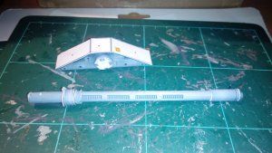

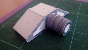

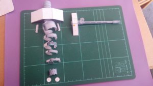

So next pics to follow: gun front side - I did not fix the parts because I am not sure how they fit, resp. how far the pipe has to go into the other part.
I will do the back parts first before assembling.

Dnalor deciphered and documented the gun assemblies very well! :)
Thx zathros - I always check dnalors threat. He does his models alway so perfect and with additional details - wonderful and helpful for sure.
dnalor wrote: Let's see if you are as crazy as I am :) - I would like to be, but I will not. I will be happy if I am able to finish the model as is. I saw that you added many additional details - great work.
Now the back part of the guns. Not difficult if you follow the instruction, but small parts...... always the assamble-problems with small parts.
