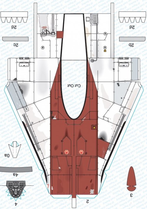

First thing is to scale down the model. Because A-wing is one of many Star Wars vehicle with uncertain and changing dimensions we have few possible versions. Official length of "real" craft today is 9,6m. It is cca 20cm in 1:48 scale and it is the way Shunichi Makino design it).
But for some fans (me included) this is way to big. Because if you look closely on original model photo with pilot figurine you will see it is no way that long. So I scale Snunichi Makinos model down to 60 percent of its original size. My model will be cca 12cm long in 1:48 scale:
Top is original model, bottom is scale down model:
Original:
Scale down to 60 percent:

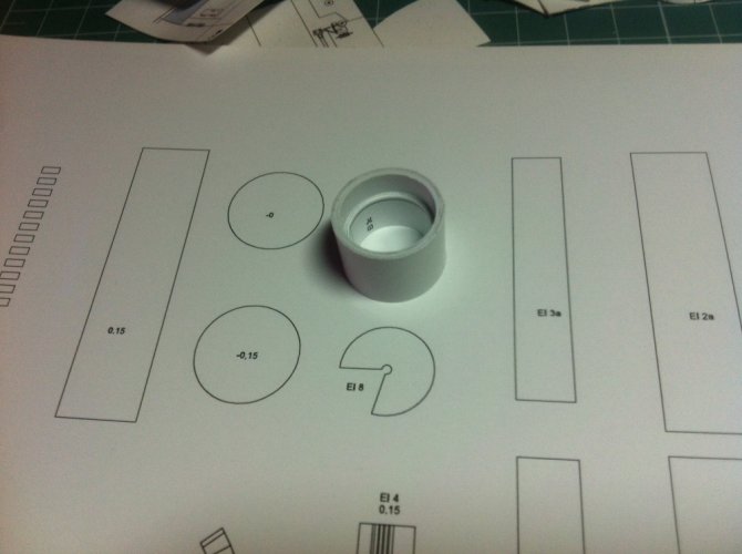

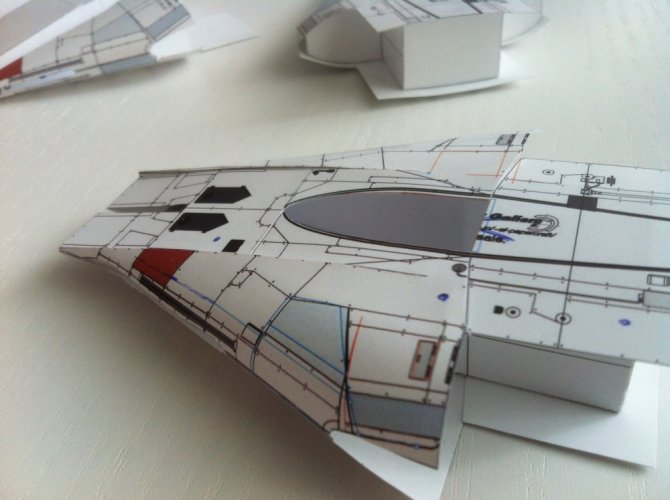

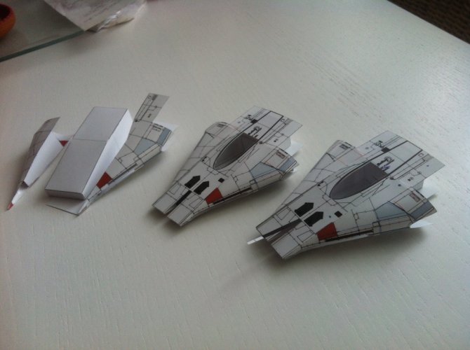

Evolution fo my test builds (from the left proof of concept, first iteration, recent one):

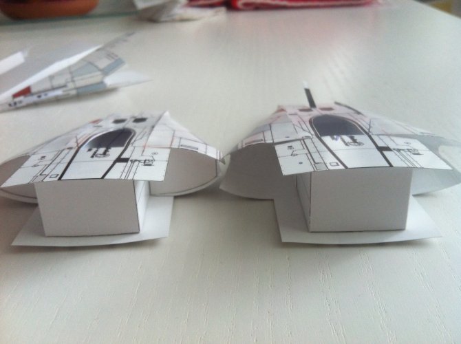

I added some height to the model (on the right) and curved the back:
I lowered center part of the nose and made it more curvy:

That's terrific. In the newer versions of this fighter they've made it flatter and taken all the curves out of it for some reason.
May be part of the infectious dumb'em down process that infects some people. Not sure. ;)

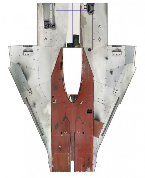

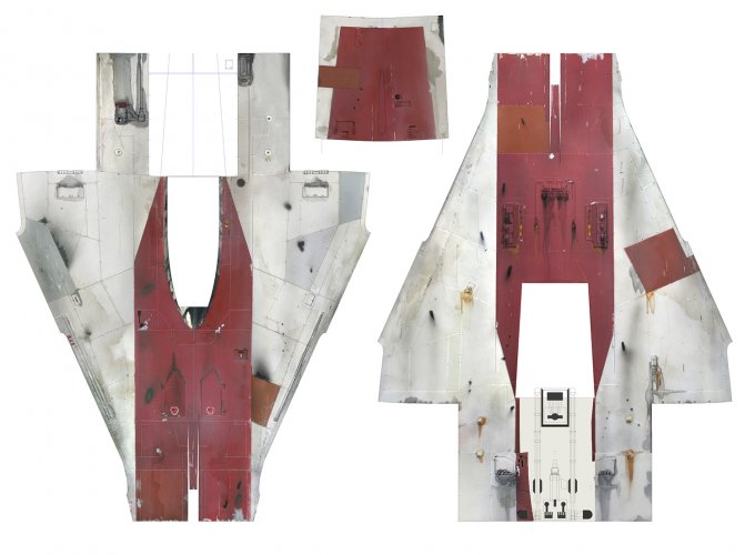

The new texture looks awesome! How did you produce the straight-on view of the upper side?

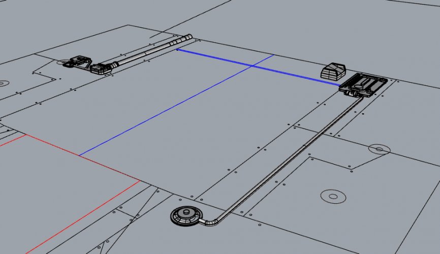

All greebles will be there Rhaven, I 3d modeled them all to see how detailed they can be in that scale:
Revell-Fan, if you mean the shape of top upper part I took Makinos part and modified it according the few testbuils I did. They can be seen in previous posts. If you mean texture it is composite of multiple photos of original model, all colorcorected to match each other and carefuly placed and distorted to match my 2d pattern. It was also wery important to erase all cast shadows and object shadings made by different surface orientation. Otherwise it would look fake on build model, because it will produce its own real shadows. I can write more details on that if you are interested.
