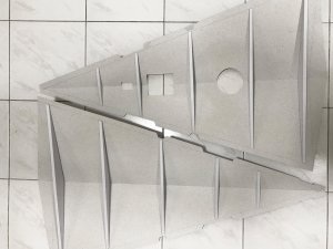

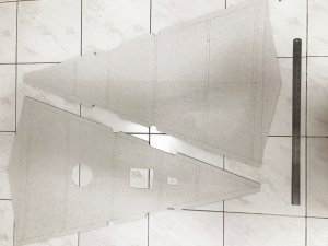

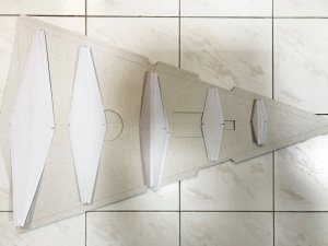

The very first update is here!
With the help of information collected from the internet and many books as a reference, now the first few pieces of this Star Destroyer are shaping up! the main top and bottom panels have been placed with supporting structures.
More updates will come soon!
PS. This is a non-commercial project
Please feel free to like and share
Please follow the fanpage to see our progress: https://www.facebook.com/PaperStarDestroyer/ 20190925.jpg20190925-2.jpg20190925-3.jpg20190925-4.jpg

Me too, go for it mate. I love big models as you can show more detail in them.
I shall be following this for sure.

I am not a paper purist. I think if you build this model and done't use something like wood as a frame, you will eventually lost it to warpage. Do what you wish, but you should consider using a framing other than paper, moisture will get in there, and you model will twist, making for a highly detailed lobsided model. Just some friendly advice. It would benice to see a detailed model of this ship, since most of them are just basic shapes with a lot of graphics of them. Good luck. ;)

wish you good luck and lot of patience and endurance to finish this project. Zathros advises you well with non paper frame. He is experienced and knowleable guy. Please consider it.
Will you model heve every detail to be the same as original? Or did you choose "it feels like the ship" approach?

This model is looking really good!! ;)

It's already starting to pop!! ;)
