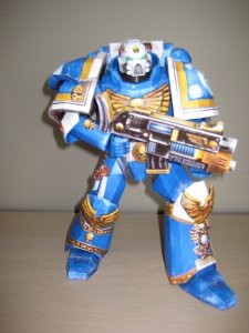

Finally done
Ok, here are some pictures.

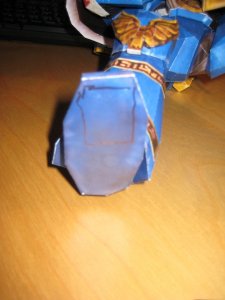

Situation before the surgical operation:
The contour of what needs to be cut:

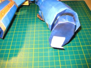

After the cut:

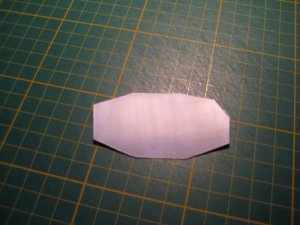

The new shoe sole:
And the result. The marine standing on its own:
