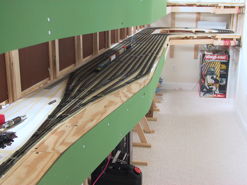

For our edification, what is reversing loop staging? I (think I) understand double-ended staging, which I assumed was the ideal solution for those who have the space, as in the CXST Shenandoah layout (image linked from that site):
Double-ended 6-track staging at each end of the layout (the other 'end' of this point-to-point being directly above it, of course). How would your alternative work?

Oh right. Come to think of it -- the picture I showed was a reverse loop I suppose, as it ended in a single track rather than a double. But other than that it's topologically identical, I suppose. But obviously they would have to be hidden -- although that's what's meant by 'staging yard' I suppose -- a yard that's visible is just a yard, isn't it? I have a (much smaller!) hidden double-ended yard, the idea being that one train disappears over the horizon and something else comes back instead. You surely can't easily play the same operations game with a visible yard?
I thought there was something more complicated in mind, as SD90 was differentiating between a 5 and 6-track yard and I thought he meant something where the rolling stock is dumped and the locos are turned round on a separate track, and the yard tracks were single-ended.
Thanks for clearing that up...
Charles

That is a awesome looking staging yard! An amazing layout too, I just looked over the whole web site!
It is similar to what I have right now, but mine is only 5 tracks. ( And the tracks aren't as long) The first switch is set with a spring, so it always goes straight, then you set which track you want to take, 1-5. They all do a big loop, (about 3 foot radius on the outside), and come back together at the other side of the spring switch. All the switches on the exiting side of the staging yard are atlas switches with the motors taken out, so they are loose. The trains just run through them and back out onto the main track, going the opposite direction they were going.
