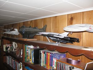

On display. Oops, I guess I should dust.:mrgreen:
Nice shot F131. Everything on that shelf is in my build queue. I just wish I had a shelf like that to put them on.sign1

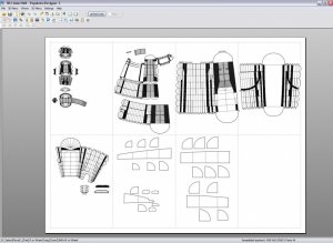

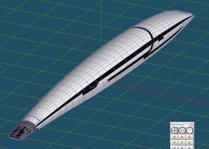

Proof of progress

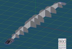

And just so you don't have to take my word for it, here's proof of progress.
The internal formers are done and the unfold is in progress. The first two pages are unfolded and just need lines touched up. The last two pages (formers) are also done. That just leaves three pages of hull sections to refine the unfold - there are a number of issues probably not visible in this image - then touch up the lines. With luck I'll get it done tonight. Then I need to go over it with an eye for the flaps
Bye for now
Bye for now

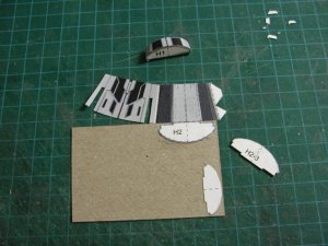

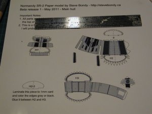

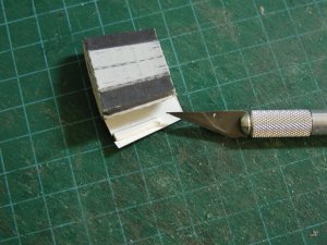

Test Building Begins

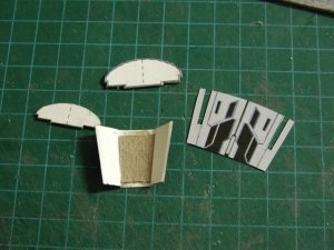

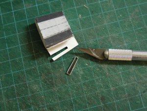

Greetings Normandy fans,
A few days ago I finally started test building the SR2. I've scaled it up to have a finished length of about 24" overall. The attached images show the initial parts on page 1 - the nose of the ship. It looks pretty small, but this is only the first couple inches of about 20 inches of hull.
The second picture is part H1 completed. I added a few inconspicuous fold lines that were missing, and removed some extraneous ones. I always re-color fold lines so they blend in as much as possible. I'll be stretching the limits of Pepakura on this one though. I like to go straight from Pepakura to PDF, instead of Pepakura to PNG, touch up in something else, then to PDF. I wish Pep could draw lines and stuff.
The third picture shows how I laminated some heavier card to the end panels of the parts for strength. Part H2-3 is a spacer that goes between hull sections 2 and 3 adding some nice detailing (I hope). I laminated it to the heavier card, then covered the outer edge with 32lb card stock and colored it with an art marker.
The next two pictures show the recessed panels in the second section, and finally the last picture shows the first two sections before joining them.
Continued in the next post....

sjsquirrel

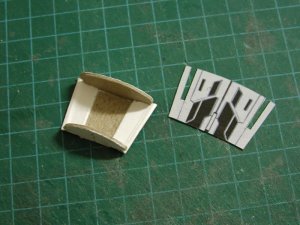

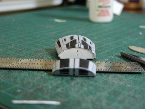

Test building continued
Continuing from the previous post...
I wasn't happy with the way the two sections lined up, and the second section didn't turn out quite right. If you look closely at the last picture in the previous post you'll see that the texture on the upper part of the second section does not line up properly with the center of the end panel. I'm somewhat baffled by that, but it had to be fixed.
I went back to Pepakura and split the hull skin into two pieces (top and bottom) and rebuilt both sections. The first image below shows the ends laminated to heavier card, the bottom skin has been scored and folded and the bottom reinforced with heavy card. This adds strength, but more importantly helps it hold the shape.
The second picture shows the end pieces glued to the bottom skin. I ended up making a vertical former to put between the ends to hold them the proper distance apart. I'll add this to the final kit, adjusted to allow for the thickness of the ends - I'll have to assume 1mm card I guess. Gotta assume something. I think mine ended up about 1.5 mm overall. The recessed panels were then added as before and the sections glued together. The third picture shows the two attempts side by side.
On my first attempt the top texture didn't line up with the center-line properly, but a slight twist between the first two sections compensated for that. The bottom side doesn't look quite as nice though.
On the second attempt there's a small but annoying gap on one side between the sections. I'll definitely be adding lengthwise vertical formers for these first three sections. I didn't include them originally because they are so small, but the curvature of the hull (see final picture) makes them necessary.
So far so good. A few problems but nothing major. The textures are looking good, even after Pepakura downsized them. We'll see better when we get to the bigger pieces.
This is the only thing I'm building now so I'll post progress a little more regularly. Stay tuned.....
Steve
Steve
