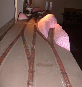

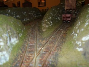

The weathered track, combined with the shortened rail joiners and some ballast will give you some really nice-looking trackwork. For an idea of what it all looks like, visit this page on my website.
Laying the Roadbed and Track - Page 1
Bob M.
railwaybob
Jun 16, 2003
419
Ottawa, Ont
www.railwaybob.com
The top photo was taken after the track was weathered and fastened to the module deck. The bottom photo is after the scenery was added and the track ballasted. You may notice that the bottom photo is looking down the track into the siding on the right in the top photo.
You have to look real hard to find those rail joiners, even at the ends of the turnouts!
The impact of weathering of the track is quite obvious, eh?
