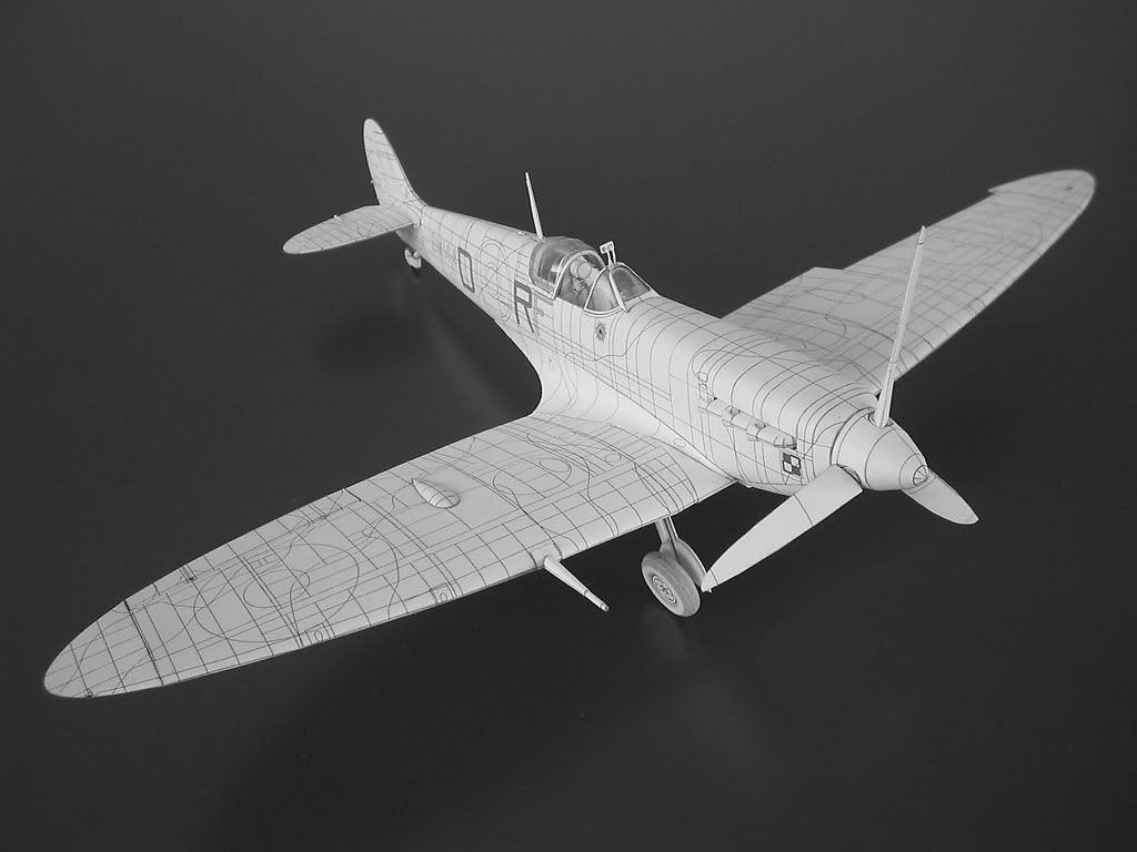

Preview of the Halinski Spitfire
Robson have given us the links for a preview of the Halinski Spitfire in another thread. I thought it appropriate to supply them here as well and suggest that we continue the discussion here, since this thread has turned into a general discussion of Spitfire kits.
The images provided (direct links below) are most interesting, because they illustrate that the designer has solved precisely the problems discussed above. Below you'll find one sample image from the links provided. From the image, you'll see how well the designer has solved the problem of the intricately curved upper engine cowling and the bulbuousness of the lower engine cowling (well, you'll see that even better from some other of the links provided below).
Interestingly, you'll notice how closely the formers seem to be placed, particularly at the nose. I keep wondering wether or not the same drawing as posted above was used...
Have a look at the way the wing fairing is executed: Two pieces to manage the angled connection to the wing. Also, the cockpit - no vacuumforming, but no less than four separate pieces to get it right. And the spinner - notice the prop mountings, and the tiny little petal part at the front, almost invisible.
If ever a kit deserved enlarging, this one surely does, as Ron already pointed out in the thread Robson started.
Note also, that the particular aircraft modeled in fact is identical (see markings) to the one in the JSC kit that started out this thread!
Leif
