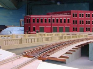

Here is a photo of the bridge guardrails I spoke of. I stll haven't tried the speckle effect with paint on a toothbrush, I'm pretty much convinced the result would not be subtle enough. What I did instead was powder up dark grey chalk and "speckled" that on dry using a paint brush with long stiff hairs. Then a coat of dullcoat. It is hard to notice but that's what I was striving for, who can see the aggragate from 50' away, as Val, I think, was suggesting. Both bridges in the photo are nearing completion now.

sumpter250

Gary,
Those guard rails look great!! That's not what I had pictured!
The bridge in the foreground looks like it could use "one more nut and bolt casting":D :D :D :D
WOW!
Are my eyes playing tricks on me, or are the rails hand spiked to every tie on both sides!!??

Gary Pfeil
May 8, 2001
2,510
Boonton NJ
Val, Pete, Thanks. Val, the building was made from two DPM kits, don't remember which ones. It has no back because it wasn't needed on the layout it was built for. I will be building another structure to put behind it for this layout, I'm leaning towards a yellow brick one for contrast.
Pete, yes I have handspiked four spikes per tie, each spike was filed to reduce its head size by about half, and then shortened so as to not protrude thru the bridge ties. I also cut tie plates from styrene strip for each tie and had to drill holes in them for all the spikes. There are 200 nbw castings on the guard timbers, all that remains now is to build the handrails for the walkway and glue on the bents, and install all the nbw castings on them. The scene is coming along!
