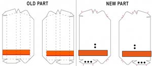

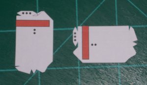

TARGETING SENSORS
I started with the targeting sensors because they are the simplest part. They are simple box shapes. I cut the tab off the long side and glued a new one made from 20 lb. printer paper from the back for a butt-fit seam. I kept the small tabs at the front and rear, as I do with most parts, because they were too small and fiddly to make new ones.TARGETING SENSORS_1.jpg TARGETING SENSORS_2.jpg TARGETING SENSORS_3.jpg a1.JPG a2.JPG

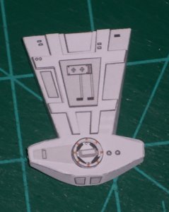

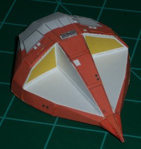

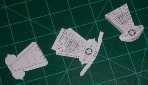

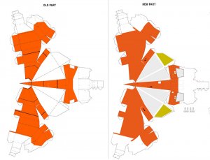

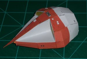

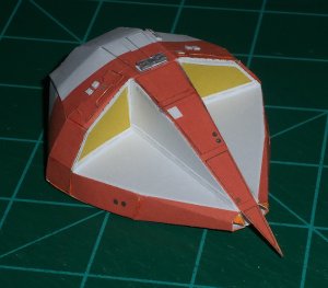

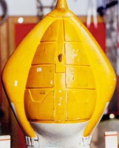

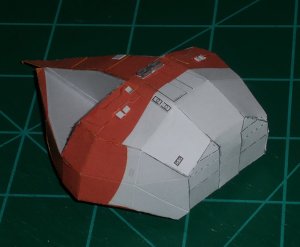

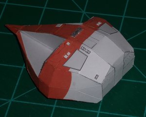

COMMAND MODULE
The command module and all the remaining parts got massive repaints. The original Hawks were built with tons of Airfix model bits and greeblies so they had a lot of detail. And, there was a lot of last-minute painting when it was decided the Hawk looked too much like the Eagle on screen (originally the Hawks were all white).

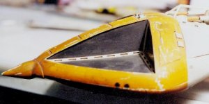

To start, I added recessed yellow view ports. The original model had no cockpit so you didn’t have to see inside. The areas around the viewports were painted white on the Hawks to contrast the black on the Eagles. After filming, these areas were painted back to black, but white is screen correct. I used a super light gray to give it some definition. I also added my version of the slotted pieces of metal that run along the bottom edge of the viewport area. It’s hard to see on the pics, but it’s there.
The orange paint scheme was off at the rear, so I tried my best to correct it but since I couldn’t quite make it work on the unfolded part.:mad: You can see what I was going for in the reference pic. I added all the various panel lines, raised details and greeblie parts I could determine as close to original position and size as possible. To make life a little easier, I printed all my newly made parts and raised areas on separate sheets.

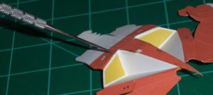

For assembly I cut off all the tabs and glued new tabs made from scraps of the same color from the old model from behind. Very small tabs were left off and those areas were edge glued using Super Glue gel. One tricky area is where the top of the viewport meets the hull (see the picture where the metal pick is pointing). I had to trim this area a little at a time to get it to fit together without puckering. I used the pick to push the edges into place and avoid creasing or ripping the part. Once the module was completely glued I started added the raised details. It’s better to do this last because gluing them flat makes it tougher for the now double-thick paper to fold or curve into its new shape. Sometime it can even cause the part to rip or the raised panel to pop off from the tension. Lastly I added the nose cone. It doesn’t match the studio model, but it’s what worked with the original part and it looks OK.:)
Next up is the fuselage, which I’ve already done a lot of work on.

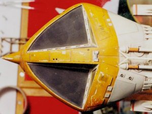

@zathros The main problem I had was how the orange paint wraps around the command module. I've attached an additional pic of the bottom. It's supposed to follow the curve and have 2 small "projections" toward the rear on either side. The rounded part on the bottom is a separate piece.
Reactions: Rhaven Blaack
13,498
9,549
So what's the problem? Deciding where to place them, you can make that section in a series of unfolded parts, and incorporate the paint as a texture. I'm working on the nose, let's see what we come up with. :)

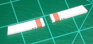

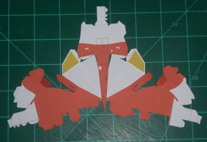

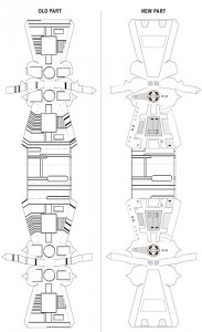

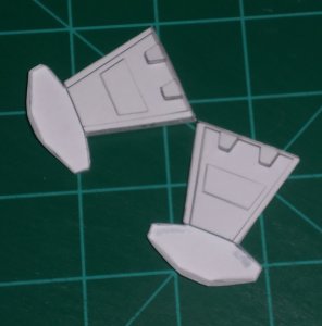

C. WINGS
Before working on the fuselage I reworked the wings that hold the main guns. I redrew all the graphics as they were not like the model at all. There are lots of raised details top and bottom and also some color. There are also some domed plastic pieces on the wing bottoms that I couldn’t replicate so I made similar shapes to take their place.
The wings are designed as simple box-like pieces with a connecting piece that is made to glue across the top of the fuselage along with gluing the wings down. The problem is that throws off the look of the model and it’s a tough piece to line up, and the wings won’t be in the same place as on the studio model. Also, I already knew I was redoing the fuselage with raised detail which wouldn’t work with the wing center piece. I cut out the center and built each side separate. I used my metal pick to poke the holes in the leading wing edge then glued a small strip of black paper behind for a better recessed look. Making the little striped circle was a real challenge. I used double-sided tape to attach the circle to 2 pieces of 67 lb. white cover, then used a hole punch on the center and trimmed the outer edge. Inside the circle there is supposed to be a hollow rounded rectangle of the same height, but that was just too small for me to make so I skipped trying to hollow it out. There are still some dome/pole-like pieces that I have to create that go where the circles are behind the rings.
On the studio model, the wings sort of wrap around the guns. You can see this in the reference pics. So I cut the outer bottom off each wing and trimmed the edge to match the model. I’ll have to do some filling of some sort when I go to install the guns but they should look better than if they were just glued to a flat bottom wing.
