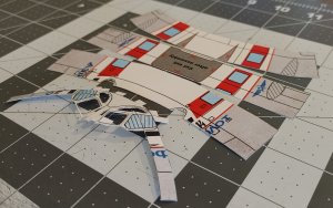

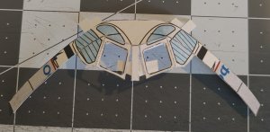

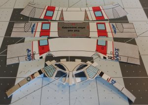

After cutting (carefully!) a couple of the windows out and doing some internal tabbing, I have reached this point.
Yes, I've made some mistakes but I think taking the time to gain some foresight and being careful and patient has helped. Once this part is done I think I'll be able to move a little faster.

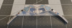

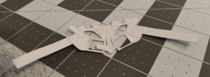

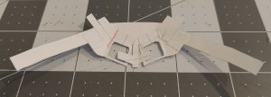

Another small update. It's coming along... slowly.
@zathros Yes, I'm cutting out the nose windows. It does make forming the nose and fuselage section easier despite creating some weakness in the structure of the model, which is helped by the internal tabbing. Also I'll be doing another layer of card to help strengthen it even more (as suggested by @Rhaven Blaack ).
@mijob That, my friend, is going to be the interesting part! I haven't quite figured out how I'm going to accomplish it, but I do have an idea of how to do it.
@Rhaven Blaack asked me if I was going to do an interior to this model (cockpit and passenger/cargo area). My answer, for this particular model, was 'no', mainly because this particular model design is not conducive to that. The model wasn't designed for that, I don't believe the model designer even considered that someone would be creating actual windows for the model. Also, to do an effective interior would require me to significantly redesign the model itself, in essence going back to the drawing board.
It's a quagmire and challenge I don't want to step into with this particular model.
Now, with all that being said, when I do other aircraft in the Antonov series of Soviet/Russian aircraft, they will have cockpits and interiors (At least some of them, depending on scale). At some point, I would like to return to this particular aircraft and do an interior.
