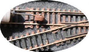

Joe's Model Trains Weathering Dye to weather track ties...
Oh, well here is a pic of the same tool using the larger (o scale) Urethane roller to do the ties (HO). Now to do the black Atlas ties, I love the "Rust" Dye that I disolve in common rubbing alcohol & that is what gives the absolutely realistic transparency that you see after it quickly dries. The rust dye actually settles into the grain of the wood ties- just like in real life! You can't do this with any spray or brush unless you go back and literally wipe the paint off the tops...but what the hec is all that mess do for ya! I use the HO size Rusty Rails Painter to do the rails and spikes with the Rusty Rails Weathering Paints- Then I use the O scale Rusty Rails Painter separately with Joe's Weathering Dye mixed with alcohol to go back over all the track ties. Best to have the two containers separate, but you can get away with just the one if you get the larger rollers in a separate pack.

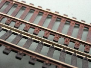

Here is a pic of what it looks like...you can't get any better than this Buddy!
Joe
