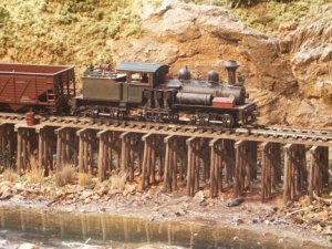

Shay No. 1 Crossing Millers Creek Trestle
Originally posted by Tyson Rayles
Casey that's very nice. How did you make the water?
Tyson, I made a "thick" mix of molding plaster which I then applied as a thin layer under and around the trestle and then on down the creek bed. Before it could get too dry, I worked it with my fingers to create an uneven, "eroded" shoreline. After it had all dried completely, I sprayed the deepest areas with flat black acrylic. Next came "damp" (not wet, not dry) brushings of burnt umber, burnt sienna, and oxide brown acrylics over the shallows. I made no attempt to keep the colors separated but deliberately overlapped and mixed them. Finally, I damp brushed and feathered in olive drab acrylic just along the edges between the deeper water and the shallows.
A couple of days later - after the paint had cured - I poured Envirotex over the whole thing. Because Envirotex tends to sink to the lowest points, some of the higher ridges of painted plaster are actually above the "water's" surface, creating the appearance of mud flats and shallows.
