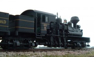

I thoroughly enjoy my Bachman though I don't have the sound chip (stuff drives me nuts). Once clocked it around the club layout. It took 57 minutes to traverse 1000'---drove the guys nuts.:thumb:
