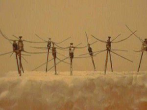

I take a normal pin, two 2.5 inch lengths of wire leaving a 3/4 section, I wind it around the pin, About 3/16. Then the second piece of wire is wound. The two top ends become the arms and the two bottom ends become the legs. A drop of solder holds it together. This is what the "armatures" look like

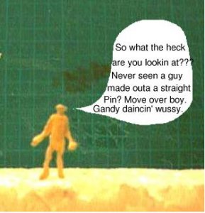

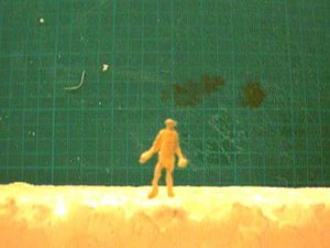

Next I cut off the bottom section of the pin.
I build up the thickness of the wire using a latex wood filler that I have thinned a little bit. This is how far I have got. Next some trimming then painting. Will post a finished picture later.
Like anything I try, The more I do the better they will get but at least this is a begining.
Has anyone else tried making people? I would be interested in any other methods.

I made up 25 armatures in about an hour of TV watching.
