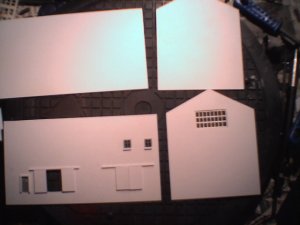

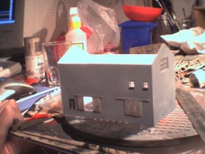

Hi all :)
This is my first scratch built building
It's in N scale and measuers 14 * 7,5 * 10 cm right now(yes we use metric system in sweden and sry about that :p )
It*s made from evergreen's sheet styrene a couple of windows that I found from another building and some Plastruct strips
As I progress I thought I could show you how I go along and hope to get some feedback cause im a newbie :)

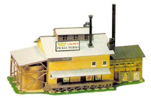

This is the building I will have as a basic insperation :)

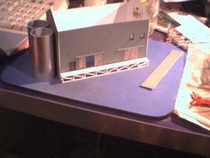

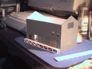

scratch built an platform by strips
the pice that lies next to the house is the small roof over the platform
I dont know how to fixate it there
any ideas? :)

CCT70
Jun 25, 2003
519
Lookn good bro. On a similar structure that I built, I used .020" wire (this was built in HO) to "hang" the roof from the side of the structure at a 45 degree angle and used styrene strip as a ledge to rest the bottom of the roof on, glued to the side of the building.
Good luck and keep us posted, it's looking great so far.

Looking very nice! The big challenge for me when scratchbuilding is cutting out neat openings for windows. Yours look great! I like that big window on the side.

Yes Ralph the windos are the hard part
specually when they measures 7 * 5 mm ;)
But I found it easier to look good if I make the hole smaler than the window I am going to use, then I file the hole to the correct size.

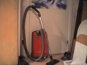

for the tanks on the side I cut a small part of the pipe on my moms vacum cleaner :D :D :D :D :D :D
I hope she dousen't kill me soooo mutch ;)
Anachron
Dec 8, 2003
100
37
Sweden
my moms now a little shorter vacum cleaner :p :p :p
well everything for the hobby right??? :D
