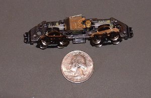

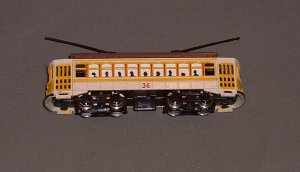

Bachmann makes a "Brill trolley" in N-scale. I think it retails around $30, but I picked up mine for $15 on ebay. It is a great little runner, from what I've seen. I've attached two pictures -- one with shell and one of the guts. The length of the chassis is 3 1/8".
The problem I've had with bashing (to HOn30) is that the lead weight is almost as big as the chassis, and is what holds the wheel sets, gears and motor in place. Basically, even with the Brill shell removed, you're stuck with a chassis that's more than 3/4" high (from the bottom of the wheels). It looks like it can be shoehorned into a boxcab, but I had planned to try to bash a small Class A Climax. Short of a massive milling project, that ain't gonna happen.

jetrock
Dec 19, 2003
894
