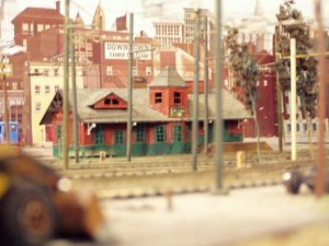

Torpedo said:
How about yard tracks under the overhead. Any issues with maintenance, coupling/uncoupling, rerailing, etc.? I have always assumed this was a primary factor for most traction modelling being done in O scale.
I have built many yards , Traction yards and freight.
I have no problem, When you start to build you will also find a way to do things that suit you.
Here is a shot from my last layout .
Get er built.:thumb:
