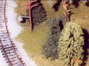

Cheaper way of gluing ballast!
Rory:
Here is a cheaper way of gluing ballast. My local hobby shoppe and RR club does this.
We use 50/50 glue. Which is 50 percent Elmer's glue and 50 percent water. Plus a teaspoon of dish washing soap. After the ballast is poured onto the tracks. Spray it with water that has about 8 teaspoons of dish washing soap in it. Get it all wet! This will help the glue to sink into the ballast. Instead of rolling off! :( Squirt your glue mixture between the rails and long the sides. Who cares if you get it on the rails. :p After the glue is dry. Use a "Bright Boy" cleaning eraser to clean the rails. There you go. Now you are done.
