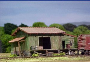

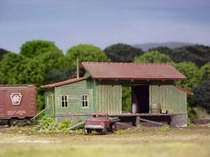

This is another example of an out-of-the-box kit that's been modified a little to make it more unique...
This is an inexpensive plastic kit by Bachman. All I did was toss the molded plastic base the kit came with, & made a foundation out of some HO brick wall sections. I used a piece of a farmhouse kit to make an annex on one end, & scratchbuilt a couple of loading docks. I also left the doors off, & added a hint of some interior detail

Now Charlie, THAT is what I call "atmosphere". It's the kind of thing I had a mental picture of when I started American outline modelling 30 yrs ago.
You got the really "used-but-serviceable" look about the whole thing. The whole setting is just right!
Ohhhhh yesssss, I really love that one!
(Now I KNOW there's a conspiracy to get me to start work again on N gauge):)

Thanks everyone, for all the kind words...getting all these compliments from modelers of this caliber is liable to go to my head! :D
Errol,
I don't think I could do any more to convince you than to point you to your own fantastic photo that you entered in the contest!:cool:
