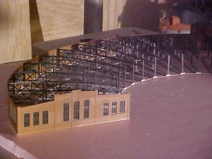

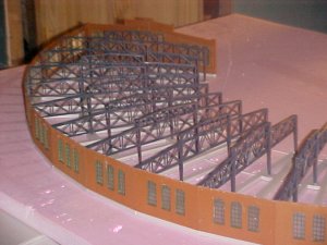

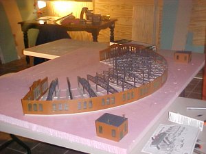

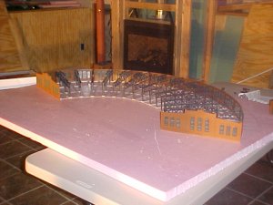

progress pictures
I will look into the small lights thanks for the tip.

steamhead
Apr 17, 2005
2,360
73
Brownsville, TX
WOW...!!! I expected to see a 5-6 stall roundhouse. You've gone overboard...!!! That's a great job. What is the framing made of? I've got a smaller r'house in my future, so any pointers would help.
And, yes. I would put lighting inside-controlled by a dimmer as was mentioned before. I've got lights in all my structures and makes for very interesting "night" operations.
Keep the pics coming.:thumb:

It is a kit from heljen, I wound up with extra windows because they use the same set no matter what the kit add on or stand alone. This is one stand alone and four add on kits. I plan on using this as the cornerstone of my layout. As I complete each phase I will send pictures.

Do you have any plans to add some outdoor tracks? A combination of lighting the engine house and having outdoor tracks maximizes your ability to not only display your structure, but also your displaying your motive power fleet.
I'd also look into creating some optical illusions by not filling the enginehouse, but placing just enough locomotives at the ride places to make it seem full.
