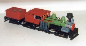

I have two generations of MDC Shays (both were kits). The first one is from 1985 with the open frame motor and works excellent. The another MDC Shay is a 3 truck version from 1995 already with can motor. It was a big trouble to assemble the model. I used all my skills to get it runnig. (I used already the informations from the famous SHAY book especially I replaced in the building phase the can motor with an another heavy duty version to wear-in the gears, as the can motor is not suitable for this job at all:curse: ) ). It is running quite well, however the trouble is with the extra tender it is to light to coop with all the forces created by the gears.
I added lot of lead but it is still a problem especially on switches in reverse mode. I am also hesitating about the NWSL drive.:rolleyes:
