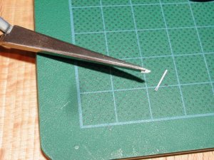

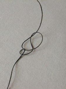

Now to the big, big secret: How to replicate the blocks and tackles.
Now, that one is extremly simple!

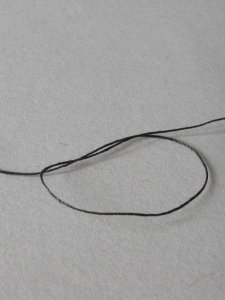

First, take a piece of thread and prepare a knot.
Put one end of the thread through the hole in the knot, thus creating a loop hole.
For things like the shrouds, which should all look alike, put something of a suitable size in the loop hole (in this case a skewer). Fasten the knot. It might be helpful to secure the knot with a bit of glue.

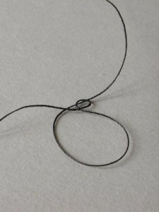

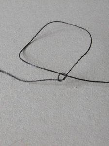

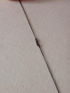

Again, put one end of the thread through the loophole,...
...make another knot, again such that the loophole runs through the knot,...
...pull both ends of the thread, finished!
For the last bit of realism, dab some brown paint on the knots to imitate the blocks.

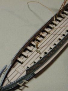

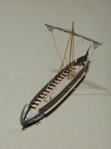

michik
Jun 9, 2004
The prepared cordage was then glued to the model. I've attached the clewlines and buntlines to two posts besides the 12th row of thwarts. My idea is that tese posts are extended deck supports. Thus, the lines wouldn't conflict with the oarsmen and the aisle between the thwarts would be kept clear, too. But this is pure speculation of me!
Here, I did a big mistake: I fastend the thread for the clewlines and buntlines to the posts and pulled it up to the yard. Thus I applied some tension to mast and yard, and as a consequence, the shruds deformed a bit. It is much better to stiffen the thread with glue and mount pieces of a suitable length without applying force!
In the second picture you can also see the rack at the stern that holds the steering oars.

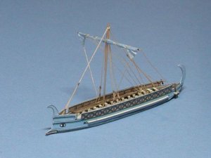

michik
Jun 9, 2004

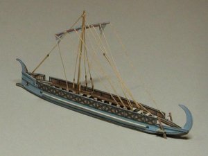

Weeeeell, and that was it already. So here are three pictures of the finished boat.
One:
Reactions: Figuer

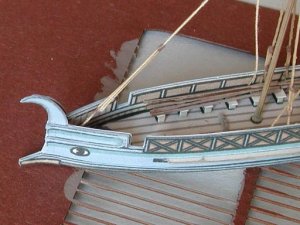

michik
Jun 9, 2004
And number three.
I hope you like it!
Michi

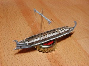

Jim:
Your wish is my command!
