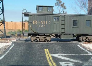

I use the backside of asphalt shingles weathered with powdered chalks then fixed in place with Dulcote. Then I run my lines and markings with a straight edge and Elmer's Paint Pens.
