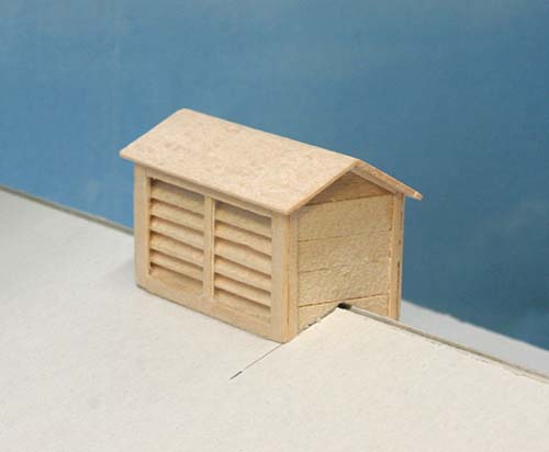

Today I tried to find a way to model the roof vents (is it that, what these hut-like structures on the roofs are called? I would not even know how to call them in German :eek:ops:). In pictures of models of the packing house I saw, that the roof vents were all built with solid wooden sides instead of louvers with single slates as on the prototype, so they did not help. Here is what I managed to do. I did not take any pictures while building it, because I was too curious to see if it would work out. But I still have two more left to do, so I can take some pictures then.

In pictures of models of the packing house I saw, that the roof vents were all built with solid wooden sides instead of louvers with single slates as on the prototype.
I believe that on the prototype, some vents can be opened or closed. So maybe the model is showing a closed vent...? ;)

Andrew, you are right, but the closed vents on the prototype still look like vents and not like a solid wall :wave:.
