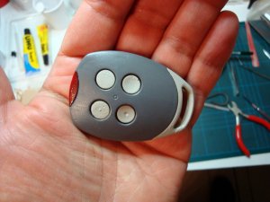

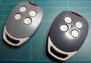

some weeks ago my wife returned home with only half of her garage door remote controller. The upper half of its plastic shell was lost somewhere in the outer world. No chance to find it again.
We bought another remote but the old one was perfectly functional, it only lacked part of the shell and the buttons. I didn't want to trash it. So the idea was to duplicate the existing parts from my own remote to replicate the lost one...
Resin casting is a useful technique - for us modelers - to replicate many identical parts from one master.
@Bill Nelson gave us a very good example in this thread.

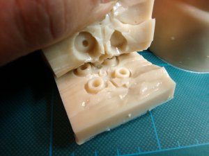

But you can also use it to double any complex shape if you figure out a way to extract your master from the silicon cast...
The only thing you have to avoid are passing holes because they can block your master inside the silicon. Putting a piece of adesive tape over any hole will result at the end in a thin resin foil that you can easily cut out from your casted piece.

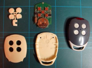

These are my original remote pieces.

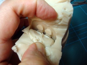

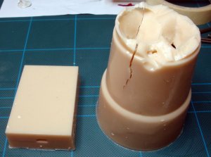

And there are the silicon casts obtained from them
They contains an exact template of the shells...
...and of the buttons.

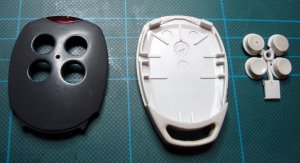

After some tries...(the difficult part is to avoid air bubbles when you cast the liquid resin) there are the best pieces I was able to obtain
And, after some painting, here are my new remote (on the left), next to his original counterpart (on the right)...
And it's not only a 1:1 reproduction: it's fully functional!
:D

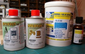

Here are the silicon and resin products I used. They are produced by Prochima, an italian company, but, I think, they are comparable to any similar product you can find near you...
