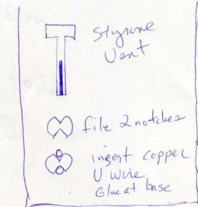

Or a rotary plastic vent switch. File two slots up the sides of the stem with a triangle file and put in a piece of copper wire bent in a U. Super glue it at the tip. Turn it 1/4 turn in above contacts it's on, 1/4 it's off. Retain it in a plastic socket so it stays straight and in. FRED

Or just cut a slot....
Instead of cutting groves and using a piece of bent wire, you could cut a slot and insert a piece of brass shim....
