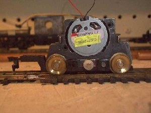

I've been considering building a battery powered RC switcher. Haven't got around to it yet, (too many other projects). :rolleyes:
The plan was to use the electronics from one of those Matchbox size RC cars powered by batteries that are recharged from the track voltage. A 3 volt motor from a cassette player would replace the 12 volt motor of the loco.
This is one of the 3 volt motor transplants I did.

Fred_M
I tried it a year ago and was unhappy with battery life. You will be suprised how much power you need and how long you run your trains. 6 fully charged 1.8 Ah NiMH would only pull 6 cars and a loco at scale 40 mph for 20 min. That was as a test bed with no electronics or such installed powering a well used Athearn GP7 with the batteries being towed in a boxcar. I didn't even run the headlight. Fred
