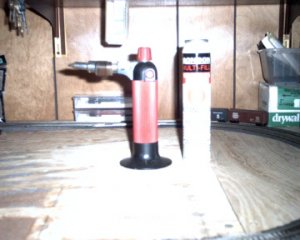

The way I solder my N-scale is I put the paste flux on the outside of the rails as to not catch any flanges then I put a piece of brass wire about a half inch long into the flux,then after my torch is heated I put a drop of solder on the tip then just touch the the joint, the solder just flows around the wire and rails making a nice neat and clean joint. Before I started doing this way I was melting ties like crazy. Now the hot tip is only on the rail for a split second.

If not. its a butane tourch about 5-6" tall which lets you shut off the flame and just use the butane to keep it hot and it gets real hot fast. I've used it to solder copper pipes in the bathroom once.

I don't understand the physics of the butane keeping the rail hot without a flame. Is this alchemy at work:eek: :eek:
