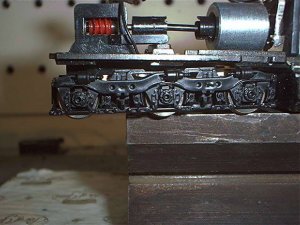

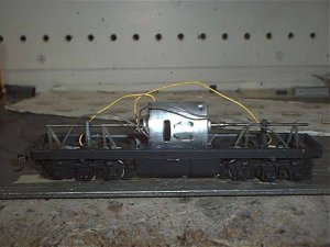

I also remotored one of my Athearn PAs.
I had to mill the frame for the Mabuchi motor to fit and make bushings to adapt the drive couplings.
The gears in the trucks were seated in valve grinding compound. disassembled, cleaned, lubed and reassembled.
I also made a stabilizer to keep the chassis from rocking on the trucks and shorting on the metal sideframes.

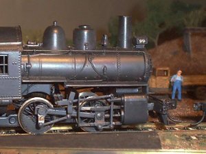

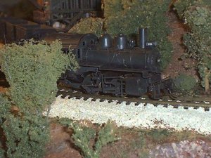

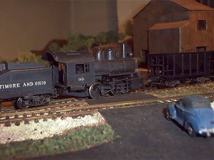

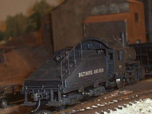

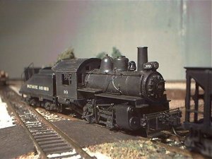

I threw some paint at the 0-4-0.:rolleyes:
I just need to put a lens in the tender light.

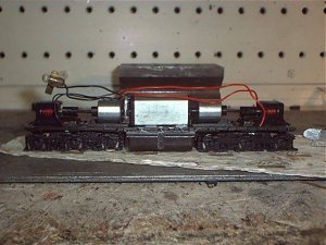

I also finished this Atlas SD35 chassis. The bottom truck covers and sideframes were broke and missing parts.
I grafted parts from a Tyco SD24 sideframe onto the Atlas sideframes and fabricated new cips to hold the bottom covers on.
Can you see the repairs?
The brake shoesand rigging on the left wheel, the slack adjusters on the center wheel's brakes have been replaced and the whole journal, brackets, shoes and rigging replaced on the right wheel.

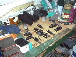

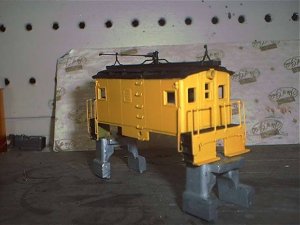

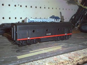

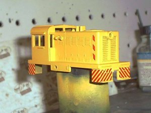

A few other things got some paint splashed on them. A pair of Globe F7B shells, some Globe truck sideframes, a couple Athearn F7 frames and the Lionel Husky and the Hustler box-cab electric got a base coat.

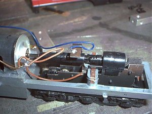

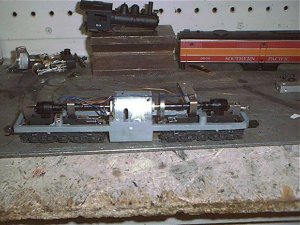

I got the pair of Athearn Hi-F F7s working that I have been experimenting with. A combination of neoprene bands and a low RPM hi-torque motor has these 2 units running great.

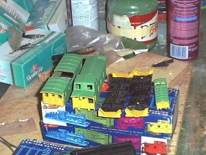

I sprayed the yellow on the box cab and Husky shells as well as a few caboose shells.

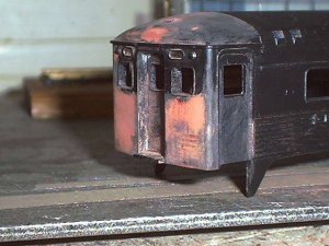

Ralph got me motivated to get my Athearn RDC done.
The ends of the roof needed to be reshaped, the pilots removed, the fluting removed from the front and the doors to match the PC units.

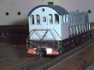

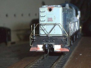

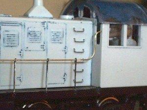

Here's the AHM Alco with railings installed.
The grab irons, coupler lift bars and stanchions are made from twisty-tie wire that was hardened by heating it over the gas stove and quickly quenching them in water. The stanchions were bent into a cotter-pin shape and soldered.
The railings are .020" brass wire.
