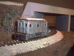

Come on in and enjoy Layout Party #6.
I'll be making and planting trees and assorted greenery on the HO layout.
Also I plan to finish as many locomotive projects I have going that I can.
Here is a partial list of them
A Rivarossi 0-4-0
An International Models brass 4-6-6 Suburban
A kitbashed boxcab electric loco

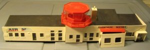

Well I tells ya, I have been working on a background flat for my switching yard layout. That's the one I am hand laying the tracks on. So I am putting together an office/crew room/freight storage type building, but it's only the side and 4 feet deep. It's just a flat. So I started with this air port terminal I got at the club auction in a box of junk. It was put together by a kid and glue is everywhere and ruined the windows, and everything. Plus the thing was smashed in the box. But it has brick walls and I never built a building with brick walls before, so there is the challenge.
Tonight I got the thing cut up and assembled into the parts I wanted for my company office. I just got out of the spray booth putting the primer coat on it. I think I'll make it gray with dark gray trim.
It will have a freight door in a 2 story freight storage area. I carved out all the windows and frames as I plan to make new casements anyway and give it an older look.

There's a lot of material to work with from that terminal. Can't wait to see the results.
The tower would make a nice control tower for a modern switch yard.

Its not that challenging at all. just slap on some PRR Toucsan red, or Southern Light freight car red dor read brick, dirt for brown, and earth for biege. i bet there are other biege colored paints you could use to. The mortar is basicly watered down acrylic paints, mixed with some detergent and rubbing alcohol.
for every part of paint, 7 parts of water, 2-3 parts of detergent, and 9 parts rubbing alcohol. just paint it on, and leave the wall flat ( its difficult to get the paint to set right on a built building, or if the wall isn't level) until dry, then put another coat if you desire. if you want it to be darker, just add an extra drop of paint. I thought it would be hard to, but the first time around i got it. you can see pictures of it in the link to my site in my signature. I don't know how well the pictures show it though.

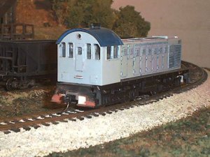

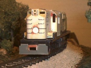

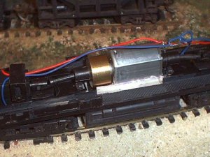

I got some photos today of a few of the projects.
The AHM Alco 1000
I remotored this with a Bachmann power truck that I regeared and added all wheel electrical pickup. It runs nice and slow but is still a little noisy. I have the gaping pilot holes filled in and need to finish the railings and other details.
The AHM RS11
I have this one regeared to a 20/1 ratio and a new motor with flywheel installed. Again I need to finish the railings and other details.
I'll start with the loco projects pictured and go from there.

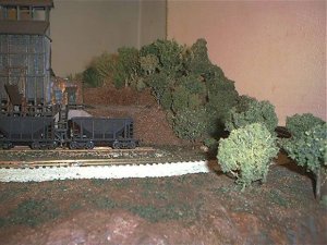

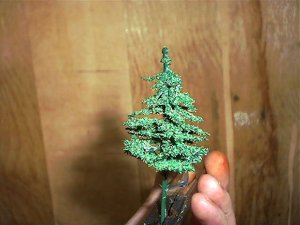

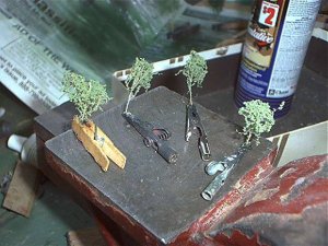

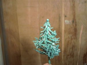

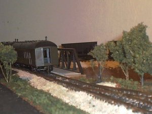

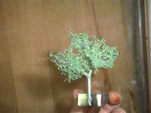

I did make some progress today.
I planted a few trees.
Here are some photos of a few of them. Most of the trees in the photos have not been trimmed yet. I use a small set of scissors to trim any polyfiber that is sticking out.
The third photo is a plastic tree that are used in cake decorating.
The fourth photo is one that has been spray painted, sprinkled with cheep Life/Like grass and resprayed.
Compare the last photo to the ones in this link. :eek:
http://www.the-gauge.com/showthread.php?t=11976&page=1&pp=15
Wow, Ray - now that's a great BEFORE-AFTER comparison! What a difference! :thumb: :thumb: :thumb:
Makes me really itchy to start building landscape on my layout. (But I have to plunk down the rest of the rails first.)
And I'm looking forward to see more of your your loco projects. You are the master of fine machinery - so much to learn from you. Thank you for sharing! :wave:

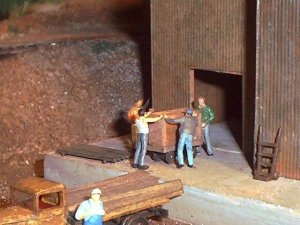

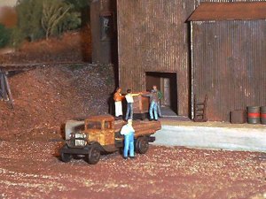

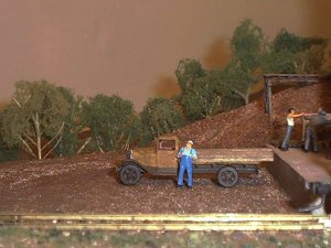

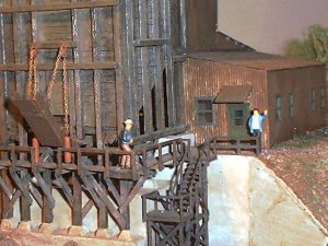

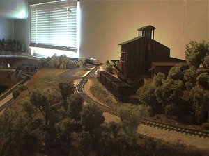

I planted a few more trees, fixed up a truck I got the other day, added some drums, crates and people to get an idea of how it will look.
