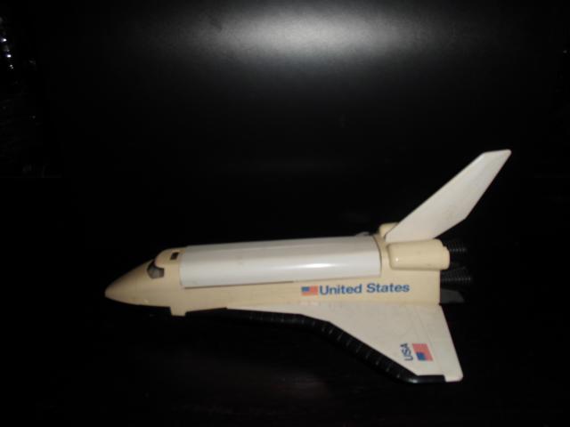

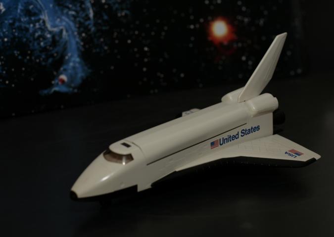

In Ordnung, ich erkläre jetzt Schritt für Schritt den Bau der Ranger 3 für Anfänger und preiswert.
OK, I now explain step by step the construction of the Ranger 3 for beginners and inexpensive.
Dieses ist mein erster fertiger Konstruktionsbeitrag.
This is my first finished construction contribution .
Sollte jemand Lust haben es zu versuchen darf er seine Fotos hier sofort zeigen. Es wäre toll.
Egal welcher Maßstab.
Should anyone feel like he can to try to show his photos here immediately. It would be great.
Whatever the scale.

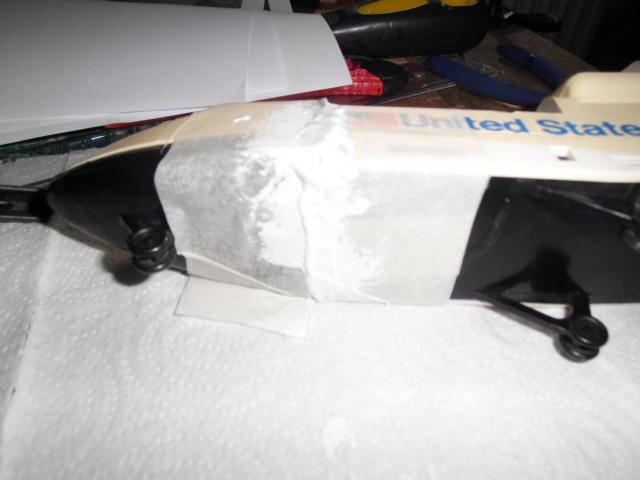

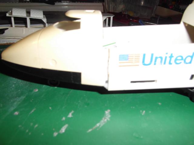

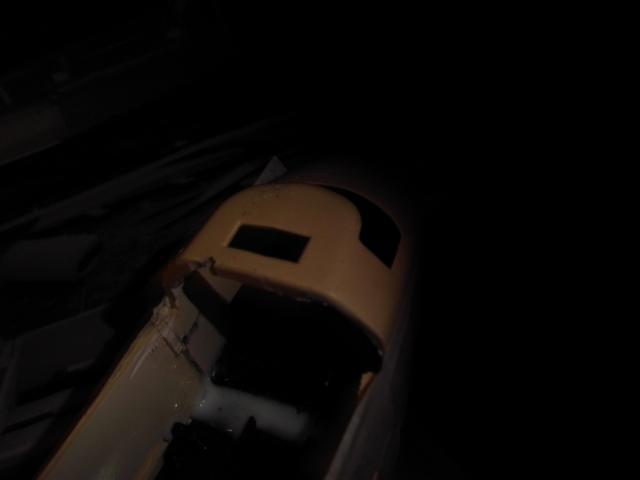

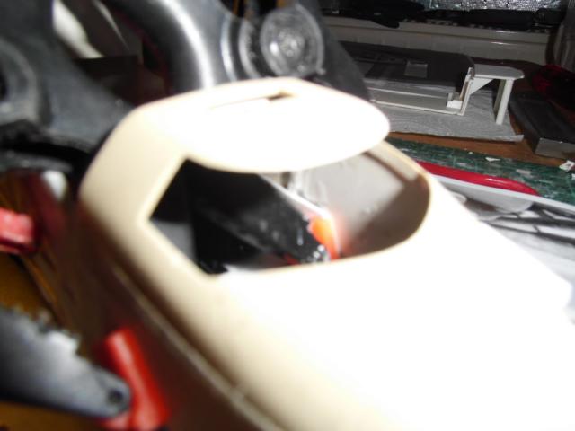

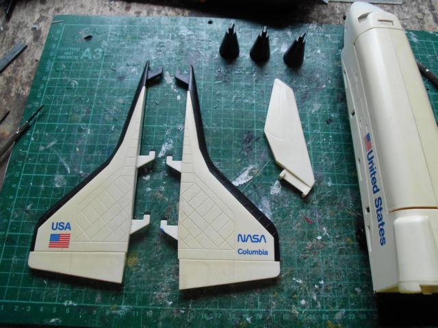

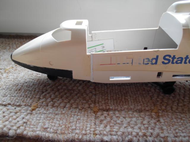

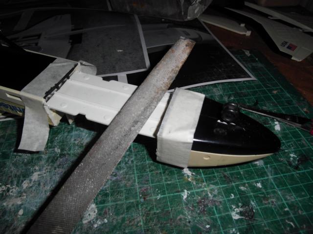

Und nun der erste wirkliche Fortschritt, für mich.
Durch das Abkleben vor dem Zerschneiden und auch beim späteren Zusammenkleben habe ich nach Ostern wirklich weniger zu spachteln.
And now the first real progress for me.
By taping before slicing and also during the subsequent bonding together I have to really fill less after Easter.

When I have to fill in a big gap, I mix superglue with talcum powder, it becomes hard like plastic, is very sandable, and hardens pretty fast. You have to do it outside though, it stinks a bit, but it works great! And it tales paint just like styrene. It makes joints like the ones you're doing very strong. You have to experiment, as I've found that different glues set up either too fast or very slow, so test out a few. The one that works best for me is Locktite.
