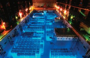

I think I'll use 2 green LED's in series with a 9 V battery and 1K ohm resistor in the line.
Since you've seen these pools in person, maybe you've seen otherwise, but all the photographs I've seen of the pools for spent fuel glow bluish-purple, from Cherenkov Radiation, like in the attached photo. Maybe a white LED, tinted with appropriately colored 'stained glass paint' could achieve this affect.

Sure, or a blue LED. I have some fantastic bright blue ones. I got them from KingBright (go to ::: Welcome to Kingbright web :::)
Depending on the light, these may look a bit greenish:
But I agree, the Cherenkov radiation is more of a pale blue.

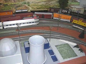

Hot rod pool cut out
SF Jack, tomd81, colton, et al, here is a pic of the cooling pond cut into the foam next to the nuclear power plant. It's about 16 ft. scale deep. Notice that it's already in green foam so lighting with blue LED's may be just right. I may not have to paint the inside, but only the outside, above for effect. Don't know whether I'll leave it open or add some type of open building for a cover. Have to look in the Walthers catalog and see if anything fits. The real one was in a building of some sort. Are some cooling pools left open? I'm going to look for some LED's tomorrow. Will keep you informed. Now I need a flat car with spent fuel rods in tow. Any ideas there? bob

D.R.Rosser
Apr 13, 2007
86
rhtastro, Your sharp picture of the cut out for the cooling pond means that you know how to post pictures! Can you walk me through the steps? This is not the correct way to get this info, but when I click on the link that is indicated to explain the process it just bounces me back to the same page. Never any clue as to how to post pictures! Need help.... Dave

SF Jack, et al, I've been working on that cold pond for hot rods and it now has a new gray surface on top around the pit. It stands out more now with the better contrast. I may try foil around the inside, it could give a nice glow. I also found all the electronic parts today at the local Radio Shack for the lighting effects in the pond. Blue LED's etc. Haven't found a suitable building as yet but still looking. I think that the one at Arco was made of concrete blocks. Does that sound logical? It would be a good shield. bob

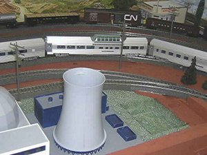

Cool hot rod pond--update
Here's the latest nuclear cooling pond pic. No cool, blue glow yet, but it's coming soon. Next will be the fuel rod holders in the bottom of the pit and a few rods. Then the cool blue green glow like Arco, ID. bob

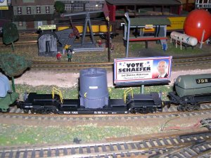

Test run of the nuclear waste car
Don't have an 8 axle car, but the idea works........

D.R.Rosser
Apr 13, 2007
86
Thanks for the help.
There is no "browse" command when using a Mac and Safari, but I tried an alternate method; it worked. Now I just have to remember how I did it! If you look closely in the picture you may notice that the car is on brass track with fiber ties. I think that is called very, very old HO! Dave

Dave, glad you got your pic on the gauge ok. Looks good. What is that thing on the flat. What kind of nuclear waste goes in there? Anyway, I want one. Re: the rails, that is old track but at least they're not wooden. Is that you on the billboard? bob

That thing on the flat car?
I used the picture with the first article on this topic as a loose guide. The body of the "thing" is most of an old 35 mm film container, with part of it cut off for a lower height. The braces around the base are plastic structural steel bits out of the scrap box, same for those on top. Caution! the film container is a soft semi-flexible plastic. Cutting and glueing is a pain! The load is what we choose; this is a private free lance road. Heck, it may from a N.Korean non-existent site!
That is not the oldest track. We have one single piece of brass and wood ties that form the beginning for a bridge that was then the first construction on the layout, put in around 1978, but actually left over from my high school era layout( 1952). Really old!
