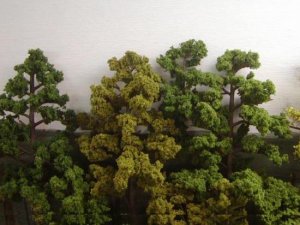

I'm working on a stretch of shelf railroad where I have about 5" of space between the track and the backdrop. As is comonly done, I painted a tree line on the backdrop, then added lots of just trunks. Then I planteda row of trees, Woodland Scenic armatures with all teh branched bent front and side, so they could be placed against the backdrop. Smaller trees and some brush are placed in front of these to provide some hiding of the backdrop between trees. It is just about impossible (for me anyway) to achieve the intermingling of branches you see in real life, and hard to get the trees very close together as a result. So the smaller trees and brush are needed in such a narrow space. However, it seemed that I needed some filler between the tops of the trees too, as they were spaced to regularly and appeared to sparse. Here is a photo of the trees just sitting in place with just two smaller trees placed in front, while I was trying to see what I could do.

I decided I could use wire to glue the clump foliage to to fill in the spaces up top. I stripped some 14 gauge Romex, cut a piece about 2" long, and then twisted some 20 gauge wire around it to form "branches" You could of course solder these together but I took the quicker way of super glueing them. Then painted and glued on foliage. Here is one done and a couple smaller ones waiting to be painted.

Here I am holding it just above where it will go, I will epoxy it in place. The bottom will be out of site, and it doesn't interfere with the existing branches.

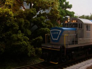

Boonton NJ
Here's a closeup of the 420, it is really a nice model. I haven't yet added the railings as I need to first add the drop steps and I want to refer to a photo. The drop steps by the way come as two fiddly little parts allowing you to install in whatever position you want. Hence my desire to check some photos. Mine has sound, and I must say it is awesome. With no programming yet, even the address, I put it on the track, selected address 3, it sounds great. The headlights are dim till you turn the throttle one step, when you do so, the lights brighten, the engine gets louder, and the loco starts to move slowly. I've had to adjsut most locos to move on teh first speed step. Then again, this is my first factory installed sound loco in some time, it looks like they have got their stuff together.

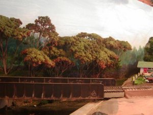

These are photos of other backdrops where I did paint treetops. Funny how I can forget things that have worked in the past! Like always trying to reinvent the wheel.

Your trees in the first shot look good, Gary, and some nice painting in behind them, too. I think I even spotted one of Bob Ross' "happy little squirrels" in there. ;):-D
Wayne
Gary Pfeil
May 8, 2001
2,510
Boonton NJ
Thanks Wayne, they are just sedum with ground foam on them. That scene was without trees for years and one day I decided to get trees in there, now. I had a bunch of the dried sedum from our garden and was only going to use it for branch material, as the plant is pretty much tops only. But here I just stuck them in the ground as is. The tree in the second photo is sedum parts installed in drilled holes in a piece of stripwood. There's potential there I haven't yet explored.
