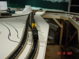

I returned home from a Greenburg's Train Show and want to update and correct this post. ALL of my Bachmann 2-8-0's have NO PROBLEM with the trackwork. :eek: :eek: I am the one that made the error. :eek: :eek: My track leading into a #6 Peco is coming off a curve and hits the end of the turnout at an angle. This is where the derails occurred. As a result of the heat warps I have redone that section of track and have straightened the entry into the turnout. I have been running the 2-8-0's for about 3 hours and have NOT had a problem here or anywhere else on the layout.:) :)
I also had some difficulty with "pulling power" on almost all of my engines. After some discussion with a Prince William Ntrak Club member I found that some of my M-T conversions needed the washer shim as the cars did not roll freely.:eek: :eek: Bought another package of trucks and couplers and spent about 45 minutes putting the washers on the bolsters and putting on the new sets of trucks and couplers. Here is the result. What I am showing here is one of my 2-8-0's hauling a string of 19 cars + a caboose, for a total of 20, up the 2+% grade with no slipping. Errol this engine is a great runner and puller:) :)

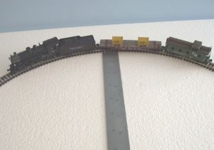

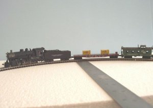

I'm not the expert on N scale, but, I finally got a chance to set up a 9" radius curve, and my N scale Spectrum 2-8-0 had no problem with the curve. In fact, at 9" radius, there was still some play, in that there was no binding of the drivers. Also ran a couple of pieces of rolling stock with no problems.
Pete
