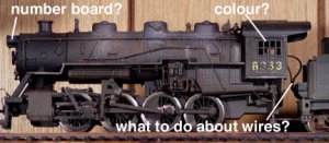

Still have some more questions as you can see from the photo below.
1. Is there a lighted number board here?
2. The window colour
3. What should I do about these wires - they don't look too good

Looks Good
Wow... that engine looks good. I "think" I am receiving a P2K 0-6-0 for Christmas. If I'm down Toronto way, could you weather it for me?! My official excuse is that I don't have an air brush, but really I'm trying to work up the courage(!) ;)
I think you are right though - the steam switchers would probably have been "let go" except for critical maintenance on moving parts. You could always do a really dark red/black to show that the original paint has been blackened by years of soot, weather, etc.

Missed your questions
I have to say - this thread is helping me A LOT with my own loco...
About Q#3 - wires. There were lots (well, some) of cables/air hoses/other connections between the loco and the tender. On my CN Pacific (#5125), I have managed to convince the wires to come out under the floor of the cab, and go in under the "coupler" of the tender. I am not sure if it is entirely protoypical, but it looks ok to me.

number boards
Val:
I just looked through some pictures, but I couldn't find any CNR switchers.
Mainline locos had a V shaped number board, illuminated, near the top of the smokebox door, exact position varied depending on whether there was a feedwater heater or other junk in front of the stack.
There was also a lovely cast brass number plate hanging below the headlight.
canadian
8338
national
these used to be available as brass etchings. They are often available as full size castings. plates are red background with polished brass (I think) lettering.

David, thanks for trying. And thanks for the info! Do you think there would have been number boards where I've indicated on the photo? It's hard to see but on the actual model it looks like maybe there were.

Val, lots of roads put number boards there on the side of the headlight, but CN seems to have put the headlight centred on the smokebox door. They put the numberboards up where your headlight is. If it looks like numberboards, you could try putting them in. Or not, if it's too hard. I probably wouldn't change the headlight, but then I haven't weathered anything either.
(remember, that's not a scale model of a CN unit.)
