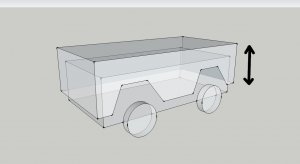

Is it possible that the APC would have an adjustable ride height? A lower position for the drop ship, and then it could be switched to a higher clearance for operations?
More than possible ...
http://avp.wikia.com/wiki/M577_Armored_Personnel_Carrier
Ground clearance is normally only 22 cm, but the vehicle employs a hydro-pneumatic, fully active suspension to allow a clean ride over rough terrain. The suspension is capable of boosting clearance by a full 30 cm and allows the M577 to comfortably tackle vertical obstacles up to 0.5 m
I think, to solve the issue of the APC not fitting into the Dropship when both are "correct" and to scale, you have to remember that neither was technically built as a fully working model - they existed as props which worked to an extent, but not operationally. We know for sure that you can't get 13 troops plus crew into the APC and so liberties were taken with the filming of the interior done in a set far larger than the actual interior space of the vehicle they built. Likewise the dropship. Differences between scale of props and sets means it's next to impossible to create an accurate representation, so Alien99 has to take a little poetic licence and resolve things as he sees fit. The result will be subtly different but no less amazing. The way forward here has to be to modify the interior of the dropship to fit since both the dropship and the APC will need to look "correct" from the outside when stood side by side.

ASC McLaren: That is most elegant and cheapest solution;), but someone want to have steering axis of the wheels:rolleyes:.....Yeah THIS is the tuning and maybe I should leave this solution to the tunners:cool: ...make them do thing their way:p...less work for me :D

What if you move only the wheels up and down? That is half way solution....OK lets take a break from the APC and focus back to the dropship :D
