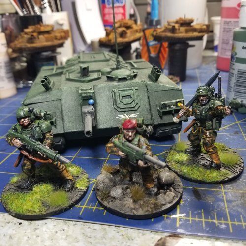

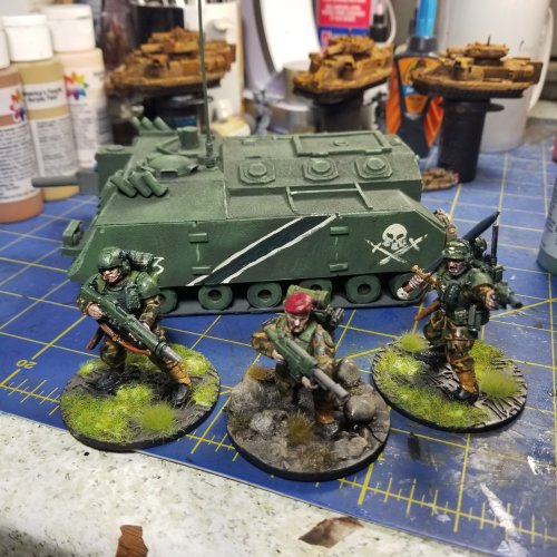

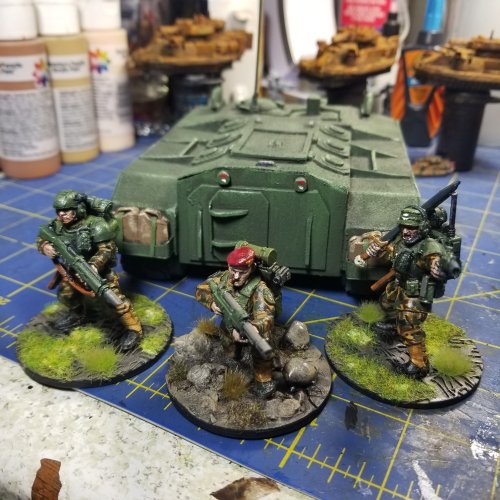

Couldn't help but put these guys in front of Silveroxide's awesome Super Chimera I finished last year. His build post mentioned it being closer to 54mm than 28mm, and I must agree after looking at it next to these guys.20241225_205433.jpg20241225_205559.jpg20241225_205656.jpg20241225_205540.jpg20241225_205513.jpg20241225_205922.jpg20241225_205952.jpg20241225_205933.jpg20241225_205720.jpg20241225_205707.jpg

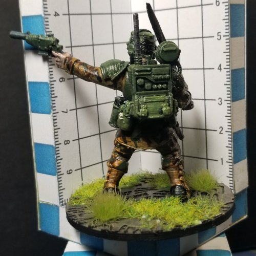

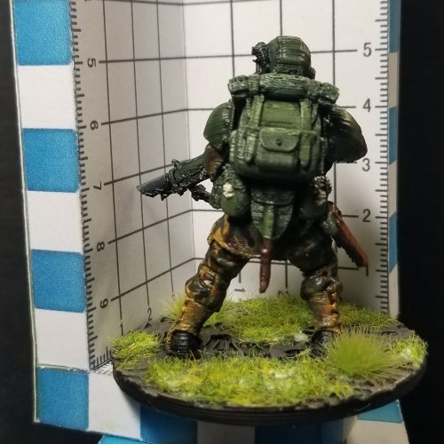

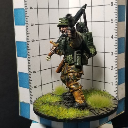

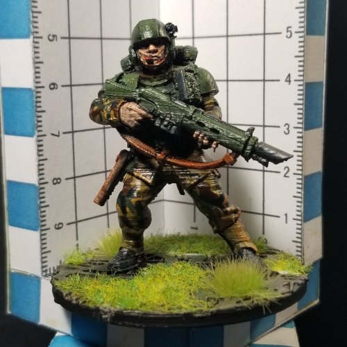

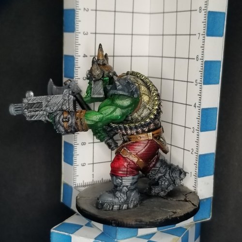

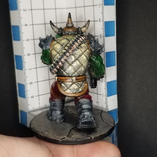

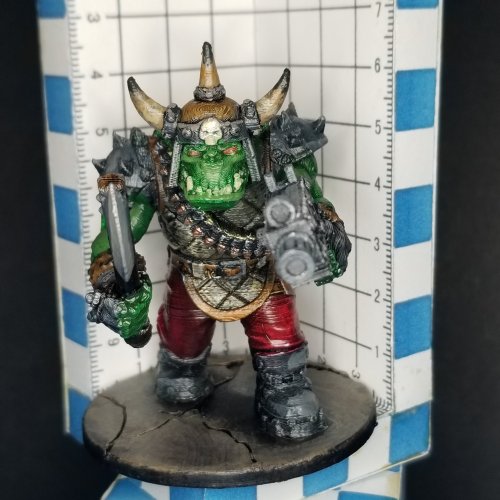

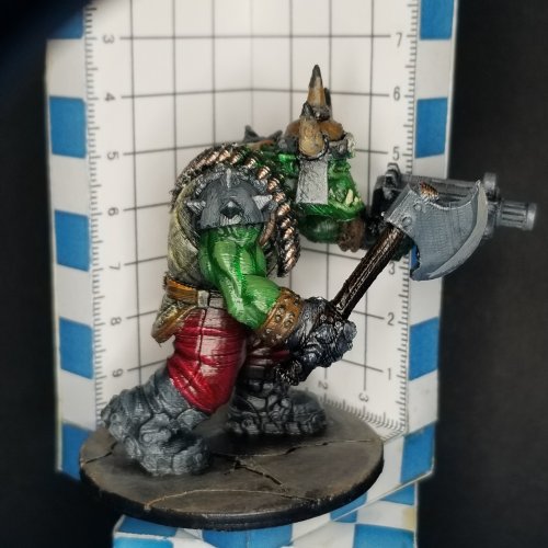

Hardcore Miniatures Space Orc Boy scaled up 160% to 54mm.
When Inprinted these on the Lulzbot Taz 5, it had an E3D V6 hot end (modified from OEM Hexagon), and a .25mm diameter hardened steel nozzle. Layer height was .1mm and I was using the latest Cura Lulzbot edition that has tree supports. Plastic is Matter Hackers Build PLA (US/North America available).
All these models look great, but have tons of strings! I have since discovered this is an effect of using hardened steel which doesn't dissipate heat as fast (and you get extra ooze and strings). Still working on finding that sweet spot with feeds and speed (temp, retraction rate, feed, and head movement speeds to be precise).
I think they came out great!! No steel will dissipate heat fast. You may want to set your cooling fan higher, to get rid of the strings. I don't know how fast you are printing them, feed, speed, printer head temperature all interact (otherwise it wouldn't work). Brass Nozzles dissipate heat faster, but may wear quicker, though with PLA, I don't think that's an issue. That's a really expensive printer. I would think that the faces would be smoother. I've seen samples from that printer and the faces are smooth as a baby's bottom.
