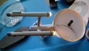

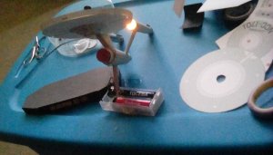

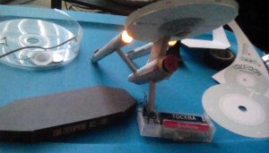

well, managed to work on the Rawen 1701 50th anniversary again today.
getting it done to put with the others. I would say to glue the navigational array together to that ring
[[[ part 19 ]]]
while its on the sheet and then cut it out. the hanger bay doors also need to have backing if you aren't displaying the inside of the bay.
for the nacelle struts, cut the bottoms a little longer and then roll a tube and put it inbetween them inside for support \0/ and also for the neck, to anchor it in, if you think you need it. also, I cut the aft saucer top and bottom to the center, because you get a warble, slicing them from back to center, relieves the warble, just glue the slices together minimally and you will fix that.
im going to size this up maybe 25% more so I can fit the nacelle lighting in easier too. but all in all its a very good model!

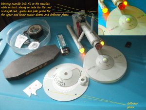

here is the latest update on Rawens 50th anniversary tos paper models, 1701. I got the nacelles leds [ 3 each nacelle, blinking amber ecandles] squeezed in, and I put steady leds in the nav lights, and a pale green dome on the under saucer, same plans for the upper saucer bridge dome, nostalgic I guess for the original plastic model I got in 1968.GEDC2427.JPG

Fine work!
12,569
8,062
That has to be one ot the tightest, cleanest saucer sections I've seen yet!! :)

I have to lay down some foil or use a water bottle cap to diffuse the light before I lay in the top of the saucer.
next: enlarged blue Rawen Klingon d7 50th modification, with purple, turquoise and amber lighting.
