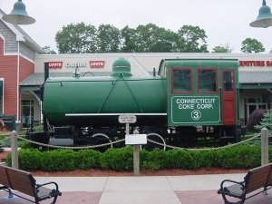

What is interesting is that it has no firebox. Tried to take a picture of the plaque write up but it did not come out clear enough to read.
"Porter Fireless"
This steam locomotive was built in 1930 by the Porter Company of Pittsburgh, PA. It came to Connecticut in 1947 for use by the Connecticut Coke Corporation in New Haven. Very unique in it's design as a "Porter Fireless", it has no boiler or firebox, instead it is charged with steam from another source and can run all day without a recharge.

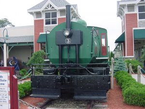

This particular locomotive has it's place in Connecticut's history as the last steam locomotive to operate regular service in the state. It has been restored in conjunction with the Friends of the Valley Railroad in Exxex, Connecticut.

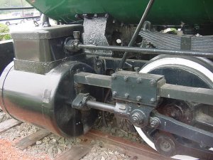

shot of left piston and plumbing

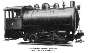

You find lots of informations here (a NRHS page). Here's another fireless Porter from that page:

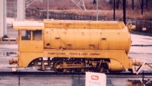

Like Bill's excellent pics showed, they came in a lot of colors. Because there was no soot from the stack, they stayed relatively clean. Here's another example in a gaudy yellow!
billk, you are right - these lokies really look almost toy-like. And yes, it's funny, I never saw a model of a fireless steamer. Come to think of it - they would be ideal for an industrial switching layout...
