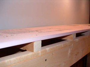

I realize I am getting into this too late but want to show how I use 1/2" foam on my N gauge layout. Works fine for me. Not weak at all. Depth to back here is 16 inches.
