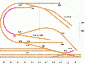

This is the layout I have designed.
It will be build on two low tables 85cm x 60cm x 25cm (33.5" x 23.5" x 10")
The two tables fit on top of each other, so they will not use to much room when stacked (I live in a small small flat in Amsterdam).
In the bottom you see 4 tracks for a station, the bottom two can't be accessed yet, but is used for expansion with more modules to the right. This station is a city station and will have passenger trains.
Above this is een loop with two access tracks, one for the top two tracks of the city station to be used by a small passeger train (steam 43' loc and 3 x 34' cars) which will carry passegers from the city to the steel mill, iron ore mine and the town above the tunnel.
An iron ore train (steam 30' loc and 5 x 30' cars) with small cars will run from the mine to the mill. (as sugested by someone else, there may be a small Z-gauge track for a mine train, running into the mine).
The steel mill wil receive the iron ore and have a long steel train (diesel 40' loc and 3 x 46' cars) run from the mill to an factory on an yet to be designed module.
This is where the second access track for the loop is for (oops, I see I have to change that turnout its and S-bend).
The hardest grade is 3.1% but there are
some grades with tight corners too, but they are traveld on only with small cars.
The era would be about 1965 germany (germany is what you get in europa, not much old dutch stuff). That was a time when electric, diesel and steam engines where all still used.
But I don't specificly model a existing place or date.
I already got the wood and just build the two module bases, that got me sweating as it was today about 35C (95F) and its not a dry heat.

Apr 7, 2003
138
sweet!!!!!!! i love that plan very cool u could make a 3rd module and pile that on top 2 u could make it a loggin module or sumthin all i know is that is awsome

Apr 7, 2003
138
j/w but is yur steel mill ganna be up in the mountain or is the mountain ganna cut short right after the tunnel?? cause them spurs cum sorta close to ur tunnel
takev
Aug 6, 2003
48
48
Amsterdam
No, the steel mill wil not be all the way up the moutain. But it is raised about 1cm (0.4") above the city station.
The town station is raised above the tunnel at 5cm (2").
We'll just have to see how close it gets, I could make the mountain stop right there and let it look like it is carved out by humans.
It is kind of busy my layout and it might be difficult to get the scenery in there.
