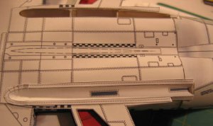

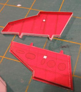

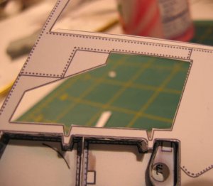

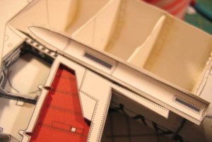

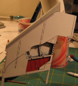

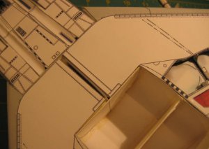

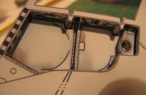

On to the wings

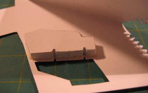

The wings are basically 2 sections inboard and outboard. I started on the right wing 1st (Republican guess). You have to build the innards 1st, the wheel well and speedbrake wells. You should gently round/crease the forward edge of the wings 1st to take out the excess spring when bending this around the wing former. When dry fitting the wells I noticed the openingds in the wing were the same size as the wells, this would've placed the wells with the ends showing on the wing underside. What I did was to cut outside the black lines of the openings in the wing. This would allow a lip for the wells to rest inside giving a much cleaner fit.

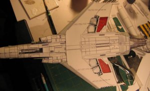

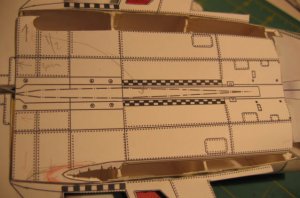

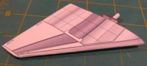

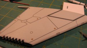

On to the wing, continued
After the wells have been installed the former is glued to the bottom of the wing, after it dries the upper part is bent around the formers and the aft ends are glued up. Do not place glue all over the former box that sits inbetween the rib parts, if you do Murphy's law states it will sink and sag to fit onto that glued box giving you a very unsightly wing. One of our members here gaave us this tip and it was well taken, thanks whoever you are.

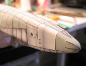

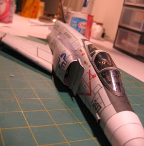

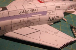

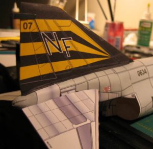

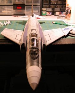

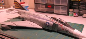

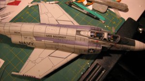

The Shape of things to come
Jim, thankyou , and the rest of the group for the push and encouragement. Just for Hahs, I dry fit most of the finished components to see what shape the bird was in. The right wing parts are done, except final assembly, the tail and stabs are done, the missiles are done, the list of things to do are winding down, detail pts, landing gear l wing underside aft and external full tank(s). Nothing in the photos is glued down yet, this was just a teaser for you and for me, something to stay focused on so that I finish the darn thing!

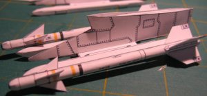

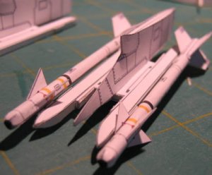

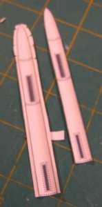

Small bits pt 1
Well after a couple days of feeling smug with the way things have shaped up, (read-builder's block), and small amounts of time available, I finished the sidewinder launch rails. I had to scavenge the correct Navy launch pylons from the Halinski F4J kit. The GPMs are correct for the USAF versions and are fine pieces as designed, but I remembered there was a differance. The Squadron signal F4s in action shows the main differances. Halinski designs a great bunch of kits and I mean no disrespect, but D--- it, there is such a thing as overcomplicated! They had you laminating to 4 differant thicknesses etc. I just kept the pylon as designed, and redid the launchers, the actual rails that the missiles sit on are part Halinski minus about 4 parts each. The final thing is more than strong enough, has a little more detail, and looks ok to me. I posed a couple Aim9Bs on the rails to motivate me further.....

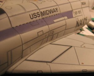

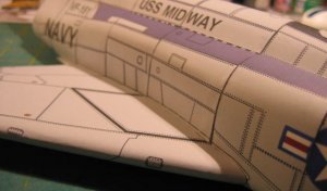

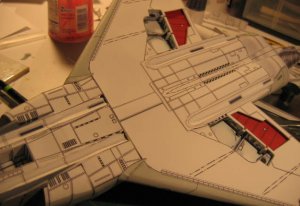

We Have wings
Today was a slight bitter/sweet day. The wings were finished and fitted to the fuselage. But... there were some fitting "Issues". The r wing fit well enough, the left however, no matter how much it was trimmed etc, still left a huge gap, at the topside root, and below. The kit does come with a very thin fairing strip for the wing root to fuselage gap, but it is too thin, and the forward section is not wide enough. There is also a part I was puzzling about for the longest time, until now, it fits/bridges the gap on the underside where the forward part of the wings are. I'll have to redesign the fairing strips to cover the gaps. Overall I'm satisfied with the build, most of the parts fit well, so some of it could still be me, but not all of it......

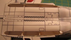

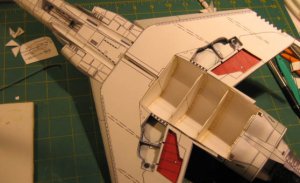

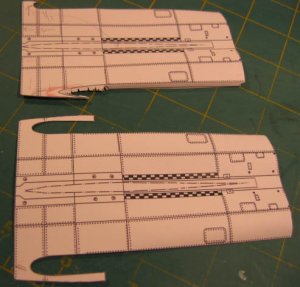

The bottom plate
The next hurdle was the bottom plate, infamous part 13. This was supposed to close the aft fuselage just forward of the exhaust nozzles and fit right up to the wing bottom halves towards the front. Well as you can see from the pic it was undersized. I think it would've actually fit with only alittle nudgeing but this also dovetails into my next gripe with this kit the Damn sparrow troughs. There had to be a better way than just curling and shoving a butt fit half cylinder down that little opening. So I redesigned the whole bottom section and the troughs.

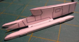

The sparrow launch troughs- again.
The kit launch troughs are little grass blade shaped pieces of plain card. The are to be half rolled and butt joined into the various gaps in the lower hull, sometimes adding to the overall structure as in the front tubes, or just detail as in the after tubes. I had a devil of a time getting the front tubes in place and looking ok, but I knew this was not the better solution. I redesigned the tubes , 1st to the correct length for the in scale Sparrow missiles, and 2 ease of assembly and 3rd for looks. The answer was to add a lip around the periphery that would hold the tube in place, look ok and fill unsightly gaps wothout being pushed too far into the fuselage. Ther may be an time where someone may not want to place all the missile load onboard. The pics show the evolution of the tubes and the final fit and placement.

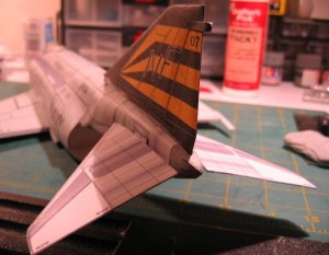

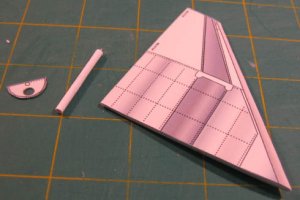

Thanks guys one and all, Sunday, yesterday here in the states was pretty productive. The 1st posting shows the Stabilators and fin being installed, the kit instructions would have you join both the rolled cylinders inside the fuselage with a bit of rubber tubing allowing the stabs to pivot in sync with each other, fine for kids but I really don't play with the planes I keep for the collection, so I just glued both to the fuselage in a neutral position. The fin fit well enough, there was a bit of gap between the fuselage and the fin but this was covered well by the kits fairing piece. The other pics in the series show the 3 parts lined up and the wing tips being attached to the main wing body.

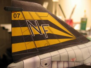

last of the "eppenage" series.
